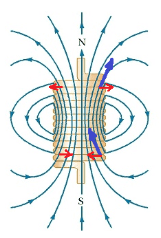

Consider the finite solenoid shown:
Note how the radial components of B (red arrows) are outward near the top and inward near the bottom. Thus, if you rotated the solenoid 180o about an axis perpendicular to the page and through the center of the solenoid, the radial components near the top will now be inward and the radial components near the bottom will now be outward. But this is in agreement with the fact that rotating the solenoid is equivalent to reversing the direction of the current (which reverses the direction of B everywhere). So, a finite solenoid can have a nonzero radial component of B without violating the fact that rotating the solenoid is equivalent to reversing the current.
But for an infinitely long solenoid, if the radial component of B is outward at some point that is a distance d from the axis, then the radial component of B would have to be outward for all points at a distance d from the axis. But then, rotating the solenoid would lead to the radial component still being outward at all points a distance d from the axis. But this would not agree with what would happen if you reversed the current. Since rotating the solenoid and reversing the current must lead to the same result, we can conclude that an infinitely long solenoid cannot have a radial component of B at any point.
