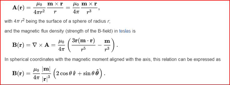

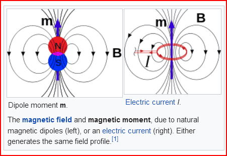

Charles Link said:
when the effects of two poles (+ and -) are considered together, the result is often inverse cube.
From the Wikipedia article on magnetic dipoles...
https://en.wikipedia.org/wiki/Magnetic_dipole
