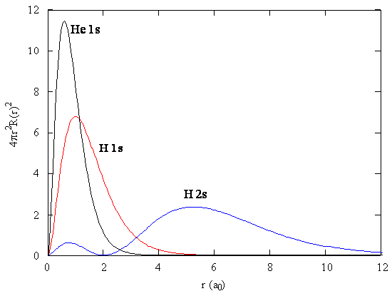

How does the Radial Distribution Function compare for 1s and 2s orbitals?

Use a (simplified) graph to compare the maximum probability (electron density) of the Radial Distribution Function for the 1s and 2s orbitals.
Just look at the plot - which function has a higher maximum electron density?
Likes José Ricardo
The Helium?
No.
You need to compare plots for the same atom, not for different atoms.
Likes José Ricardo
Borek said:
No.
Ahhh... I think the hydrogen has more density for in the 1s level.
Am I correct now, professor?
I had this class, but my professor doesn't explain good. I learn more with videoclasses on Youtube than with him.
Don't professor me.
Yes, in _every_ atom 1s orbital has a higher maximum electron density. Note: it is important to be precise, "higher maximum density" means something else than "more density".
Likes baldbrain
