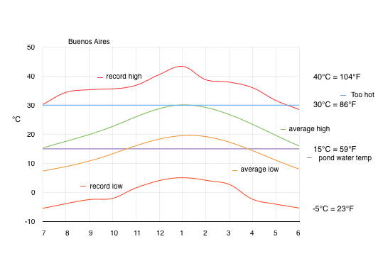

I have the fortune to have a lake at the end of my yard, I measure the water temperature at its deepest point, which was 15 c at 10 meters deep, but a place of 8 meters deep is much closer and according to my measures is also between 15 c and 16 c (these measures were taken passing mid summer last year).
Is not a surprise, because cold temperatures of the winter reach the bottom of the lake, which by stratification stay there until the next winter because sunlight does not reach that depth.
I want to exploit those cold temperatures to cool my house in summer, my house already has a radiant floor in all the rooms which is used with a boiler to heat the house in winter.

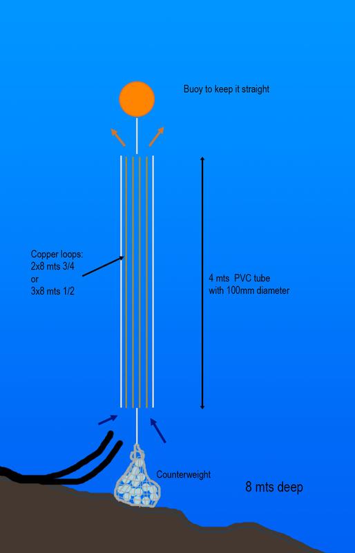

I want to use 1´ 1/4 of polypropylene black hose (the one that it is used for automated irrigation) to connect the collector to the loop in the lake (to avoid energy lost by friction), it would be thermal insulated with an extra layer and 20 cm buried until it reach the lake.
I have doubts about the material of choice for the loop, I know cooper is the best thermal conductor, but not sure about its corrosion, because water samples that I took from the lake bottom has a bit of rotten egg smell, which could mean hydrogen sulfide which in fact can corrode cooper (I guess). Another issue with cooper is that (if corrodes), high levels of copper sulfate could be bad for aquatic life, but some levels of copper sulfate are used for algae control, I made some math, and even if all my loop stays trap down there and dissolves (not my intention), it would be still 2 order of magnitude lower than the recommended level (I can add those calculations if you want).
The problem with polypropylene loop, is that it looks ugly due how massive it is, which can be seen in this picture https://plasticpipe.org/building-construction/12-geo_files/csss_images12/12geo.jpg
Then we have the fact that plastic is also polluting.
But those polypropylene loops are used to extract heat from ponds that are not deep with the help of a heat pump, so I am not sure how long they would need to be for my special case.
I can't do the math, but my common sense tells me that 2 copper loops in parallel of 3/4 by 10 meters each, could be enough for what I want, of course that is a total blind guest, because I am not sure how fast would be the cold water natural convection from the lake touching the copper pipes in order to cool them.
I will enclose the cooper loop in a cylinder tank with holes to avoid any fishing line stuck, but nobody fish there anyways.
So.. the question is.. Somebody knows how to approximate the length needed to accomplish at least 29 c inside the house on days of 40 c?

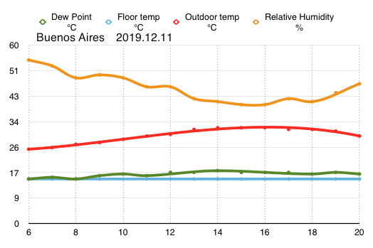

I understand that if I achieve 29 c inside my house, I will still have all the latent heat from moisture, and I also know that if the moisture is high the dew point could be reached which the floor would start to condense water.
But those problem seem easier to manage, because I can control the pump speed and I also have a medium AC unit for the living room of my house to help to reduce air moisture. I also have ceiling fans in many parts of my house which can help to vent hot air over the floor to maximize efficiency.

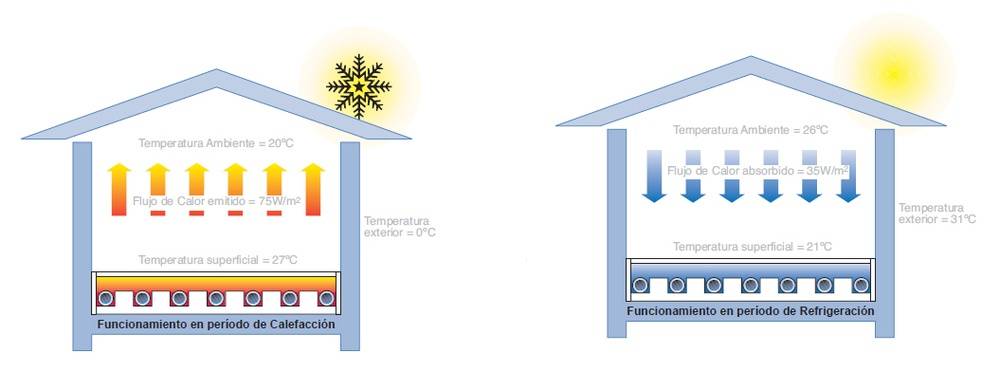

This method works by using a large surface to absorb the heat radiated by other objects (in this case the floor), you also have some heat conduction by convection between the air and the floor which reduce the efficiency vs "roof radiative cooling", but not by so much, in fact floor + ceiling fan would improve the efficiency vs roof alone.
This method of radioactive floor cooling is even used in some public infrastructure.
The average temperature of a room depends on the thermal mass of all objects in the room + the air temperature with its latent heat.
The thermal mass in furnitude, walls, roof and floor is much higher than the thermal mass in the air.
All objects had similar temperature because all objects radiate and absorb heat from other objects.
If one is at lower temperature, it would absorb more than the heat it would radiate, reducing the temperature of all other objects.
The air can also radiate and absorb heat, but mostly interact by convection.
Even if the air would stratify in a room reducing the interaction between the floor and the air.
You would still feel a cool sensation even if the air stays hot, because your body is radiating more heat than the one it absorb.
The advantage of radiating heating or cooling, is that you need lower temperature difference because your radiator/absorber area is larger, this also improves your efficiency. If I use splits to distributing cool air cooled by cool water, first I need lower temperatures than 16 degree to make those work and they are more expensive than normal AC units working by compressor.
In my case, I already have the radiating floor for heating, I also have the lake, so I want to merge those two, I am not expecting huge results either, just keeping the temperature below 30 c is way better than dealing with 40 c.

https://www.sciencedirect.com/science/article/pii/S0196890411001014
In this example 7 degrees of difference are calculated by the heating case and 5 degree of difference for the cooling case: (it is in spanish, sorry, I could not find an english version).
Source: http://vgatec.blogspot.com/2011/11/
Heating case: deltaT= 7 degree = 75W/m2
Cooling case: deltaT= 5 degree = 35W/m2
So if we count those 2 degree of difference, it looks like it would reach 55W/m2 which it would match with the 25% of natural convection which is lost in the cooling floor case.
I think that using fans those 55W/m2 could be double, which can help to accelerate the cooling until the house reach comfort temperatures.

If the amount of pipe submerged in the water is adequate enough, then you don't have to worry about its type. The amount of surface area exposed to the temperature can compensate for difference in thermal conductivity.
Copper would be more expensive, and as you say, possibility problematic with corrosion - do you want to bring the thing up every so many years to replace if it does corrode - and if it does your system under the floor will become contaminated with lake water, further complicating your problems. Ugliness is hidden under the water.
Would the possibility of a leak in the river water system necessitate a heat exchanger as a barrier between floor system and river water system - so that you then have two loops -river water system and floor system. There might be something in the code for housing to follow. See geothermal.
Such pipes should go below the local frost line. Are you sure 20cm will be adequate?

Good! You've noted the problem with condensation.
I nabbed todays forecast temps and humidities from weather.com and discovered that without a fancy controller, you're going to have an indoor swimming pool!
You are well positioned, with the lake and the sub-floor pipes already in place. I think I would proceed by experiment rather than calculation. There are so many unknown parameters in the calculation that confidence in any answer would be low.
You mention existing AC. If you have a heat pump, then lake water could be used to pre-cool external air coming into the heat pump. It could also pre-heat incoming air to the heat pump in winter when you are using heat. In both cases, it would improve efficiency (COP) of the heat pump. That is not exclusive of the sub-floor idea. The water could be circulated to both the heat pump and under the floor. Those two uses could be connected in serial or in parallel. I'm not sure which would be best, but it would be easy to include some valves to choose serial or parallel pipe connections.
I would worry about condensation on the floors if they are cooler than the room. The dew point of the air in your house is an important parameter. Also beware the risk of freezing pipes in winter.

In the graphic that was posted here about buenos aires climate, it said that you can find some days with -5c, but in my experience are very rare the days with less than 0c, and if that happen (-5c) it would be over few hours on the night.
Still it is a concern as you said, not sure what would be cheaper, to add more insulation, to pay for a deeper ditch, or to circulate just that loop if the temperature goes very low.

Also, that system on the picture is not for a small household sized one, I guess?
What site is that? I like the dew point data.
It is a special software?
Even in this case, the dew point would be 17c, why the floor is at 16c if the lake is at 15c-16c, that would not require a huge large loop for such small detalT?

I am also trying to improve my heat exchanger design:
The benefit of this approach is that I enclose all copper (or hdpe loop) inside an open PVC tube to exploit a kind of chimney effect which I guess it can improve the heat transfer.
This also reduce the dirt that can accumulate over the copper, because the cooper coil horizontal section is almost non existent. It seem also easy to deploy in case the lake floor is not flat.
It is also easier to raise lifting from another rope attached to the buoy vs my previous version, this could be also used to shake the whole exchanger to remove any dust sticked.
The PVC tube also provides structure and protection vs fishing lines.
Joints or "U" turns were not drawn to simplify the sketch.
The U turns could be in the outside of the tube in order to not block the natural convection.
It does not matter how long is the PVC tube because it extract always cold water from the bottom.
In case I use HDPE, I would have to make 4 of those or increase the diameter.

Something I did not take into account in my new heat exchanger design, is that the lake water temperature at the top of the PVC tube would be higher temperature than in the bottom, this in part interrupt the natural convection that I wanted to achieve.
I still love many of the benefits of the vertical approach with the counterweight and the buoy. But I would need to make it shorter I guess, maybe 2 meter with higher diameter.
