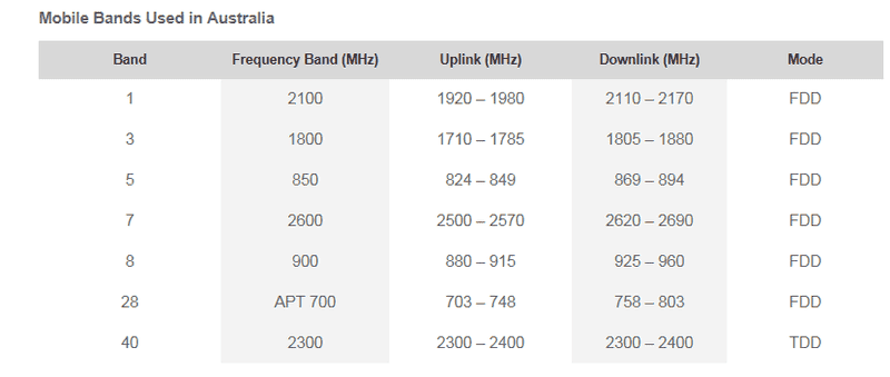

So the mast frequencies are safer?
not necessarily, depends on power levels. Also, many cellular frequencies are very close to the microwave oven frequency of 2.45 GHz
For example, here is the Australian cellular bands...

To expand a bit on Russ's post:
Note that the linked article states that the microwave is "leaking at the British Standards Institute limit".
So the 0.5 V/m is the maximum allowable leakage from a microwave according to these standards. In other words, this is the maximum leakage that is still considered safe for a consumer to use. That doesn't mean that higher amounts are dangerous though. We tend to err on the side of caution in situations like this. If exposure to low intensity microwave radiation is dangerous, then the effects must be very subtle, as we don't see any obvious damage in the short term and the long term effects must be small enough that they are buried within the noise from thousands of other health hazards you face every day.
