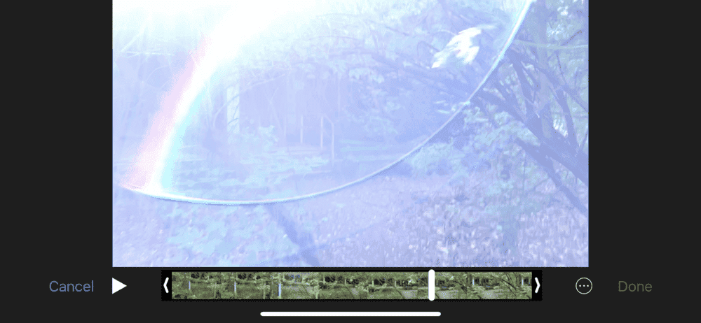

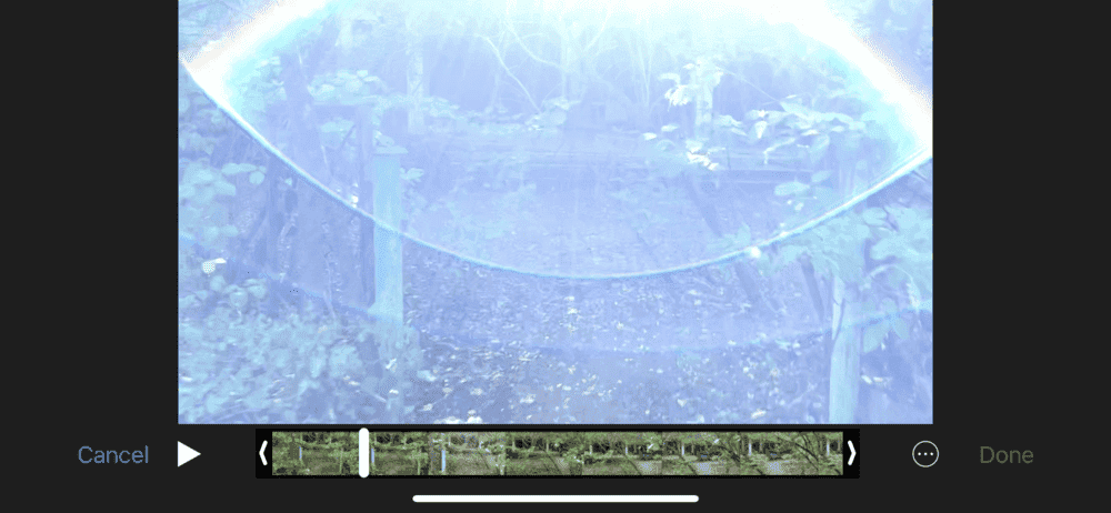

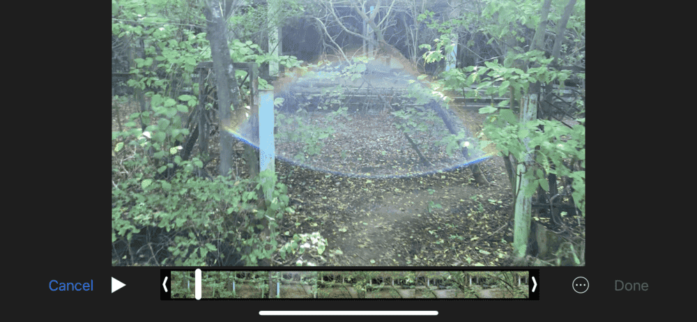

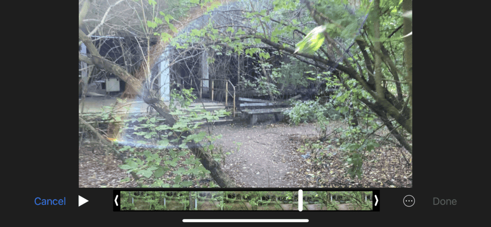

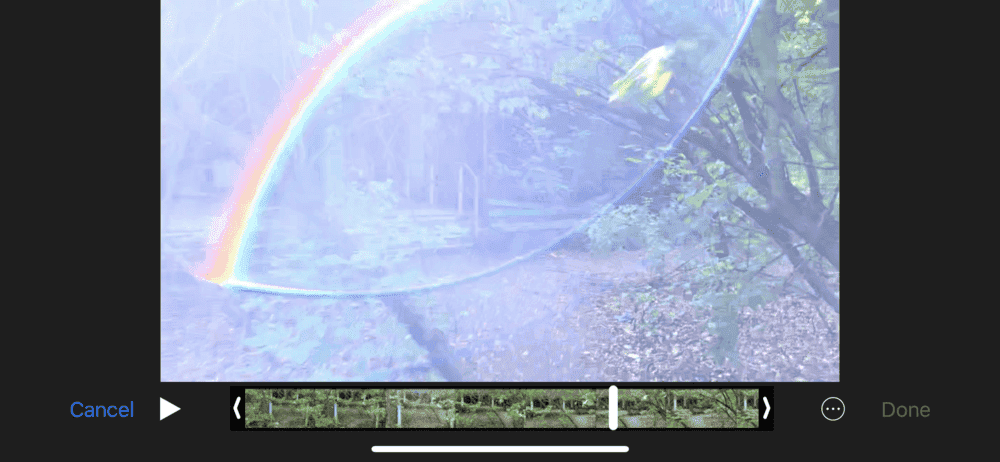

Whilst visiting Pripyat I took several videos. Great care was taken to stay away from any contamination hot spots and we had an experienced guide. Most of my videos are great quality, but two videos have captured short quick bursts of bright lights and rainbows which appear for very brief moments (a matter of a fraction of a second). My camera was set to film at 60fps in 1080p (IPhone XS).
Does anyone know what would cause this? Obvious answer was radiation but I can’t find information of this anywhere on the net, or at least similar examples. I’ve posted pictures below of the moments where the light appeared. I’ve never seen this before and the phone is fully functionally. I have taken several videos since outside of Chernobyl and I can not replicate it. The Geiger counter at the time of the lights was reading between 0.2 micro s/hour to around 1.5. I took pictures in areas which higher readings and there was nothing showing in the photos. Could I have walked through an area where there was a very high level of radiation perhaps? Wouldn’t the Geiger counter have picked this up? What levels could be expected to cause interference with the electronics in the phone?

Looks like perfectly ordinary lens flare. Possibly in combination with your camera doing whacky things trying to set the exposure and white balance.
Likes russ_watters and Klystron

Likely some unfortunate reflection you did not even notice there. Do you have a ring for example, what could cause reflection?
Radiation related artifacts on modern (semiconductor based) cameras are white spots (as some gamma hits the sensor): some artifacts on compressed/recorded images/videos and damaged files (rare: memory/chip problems due radiation), malfunction of the camera/restart/freeze: same reason as before, just not in the image storage area (more frequent, but still rare: it is just usually blamed on software bugs).
Everything on those pictures speaks about regular (optical) source.
Likes russ_watters
0.2 uSv/hr is not very much. For that matter, neither really is 1.5. You probably got more exposure flying to Pripyat than walking around Pripyat. Despite the horror stories on lenses blackening and electronics failing (kind of misleading since they are in environments with thousands of times as much radiation, perhaps even a million) there's no reason to think this is radiation. As others have said, it all looks optical.
