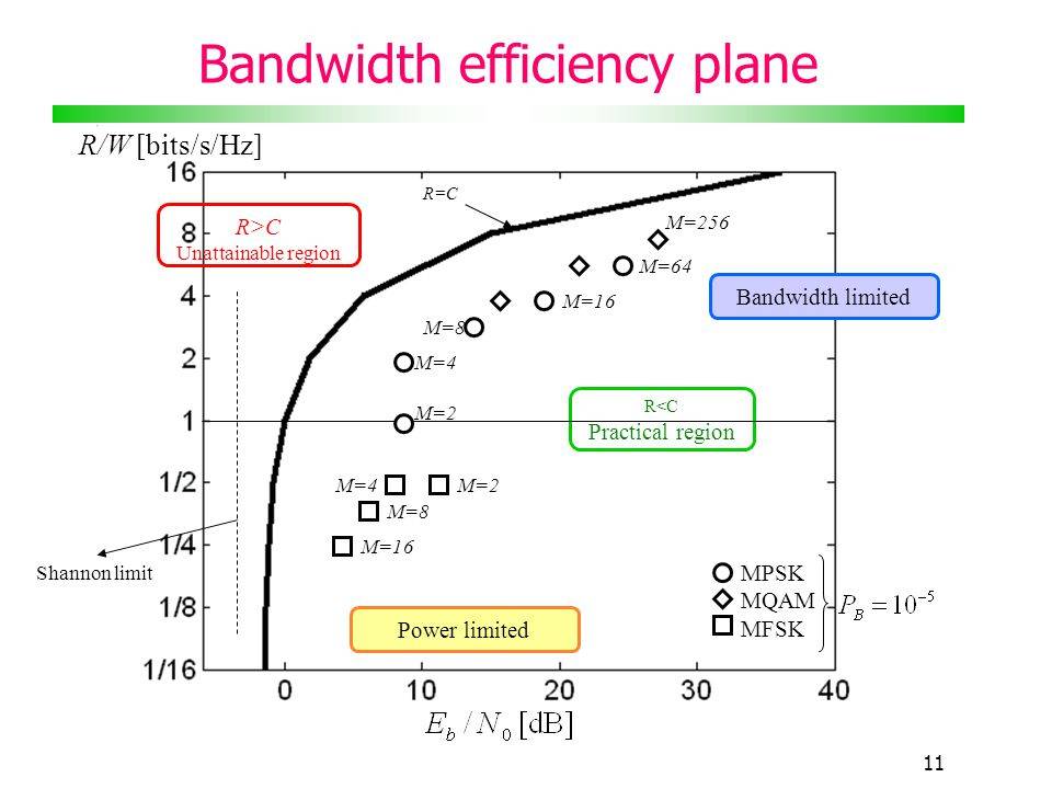

I think so, it's just the difference in frequency range and bandwidth, but the songs you send will sound the same.
Let us consider the digital communication system. In theory, the success of lossless transmission can be achieved at very low or very high carrier frequencies, and even within very narrow bandwidths, which may come at the cost of reduced data rates, and when the transmitted signal power are lower than certain values, real-time audio / video transmission may not be possible.
On the other hand, what the important is to choose the correct modulation scheme to achieve an appropriate trad-off between power and bandwidth to obtain system optimization.
I think this could be a gear change too high for the present thread.
It's a very difficult thing to 'equate' an analogue channel with the digital channel that will carry all the relevant information in the original analogue signal. The actual information on the analogue output of a microphone can be very high indeed. The precision with which the transducer produces Volts for instantaneous sound pressure will depend on linearity and noise etc.. Do you need to transmit all that information? MP3 tells you that you really don't.
AM wastes a lot of its bandwidth by trying to transmit the effects of non linearity and noise in the original baseband signal, whether you are after the highest Fi or the lowest quality telephony. Digital coding treats the analogue input signal in a sophisticated way that selects the 'really important' information only and it produces a signal that is almost impervious to channel noise until it reaches a threshold level - at which point the channel will just die.
So which system is 'better'? Ask the users of Digital TV and Sound systems. (Also ask people who drive through fringe areas where the signal keeps cutting out completely when they could have been listening to 'intelligible' but 'wasteful' rough AM audio.)
