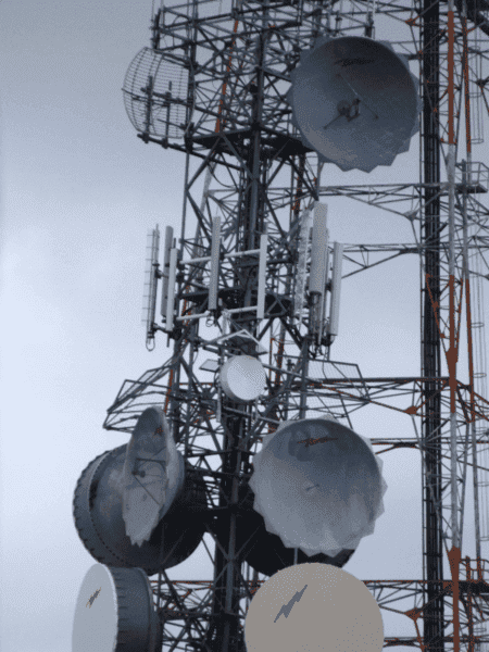

microwaves are just radio waves
microwave communications also use antennas, look around where you live and see the dish antennas on towers
I'm sure you have seen them before ?
this is a tower not far from my home
all those round dishes are for transmitting and receiving microwaves

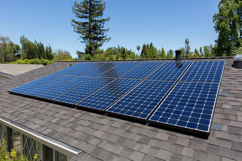

light is used for the generation of current in solar panels (I am sure you have heard of them ?)
