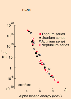

But why do some unstable nuclei decay faster than the others?
For example:
Decay modeHalf life
Bismuth_209alpha≈2×10^19 years
Beryllium_8alpha≈8×10^-17 seconds
Have you looked up the other properties of these nuclei? For example, have you looked up the binding energy per nucleon of Bismuth-209 and Beryllium-8?

A M said:
Here
Where are you getting the value for Beryllium-8 from?
  • #31
Wikipedia
  • #33
  • #34
Alpha decay tends to have a shorter half life if the reaction releases more energy. It can be a bit more complicated but that is the general trend.
  • #35
A M said:
The more the difference between a nucleus an its decay products, the faster it decays.
It's not always that simple. Consider a couple of examples.
First, Beryllium-8. Its mass is 8.0053051. It decays into two alpha particles; twice the alpha particle mass is 8.005204. The difference is 0.0001011 amu, which is 94.2 keV; and the Be-8 nucleus is heavier. In other words, a Be-8 nucleus is basically two alpha particles plus 94 keV--the only reason it exists at all is that it's a resonance, i.e., when two alpha particles happen to come close enough together they can briefly form this state before splitting apart again. So the "half-life" of Be-8 is really just the length of time this resonance state exists.
Second, Bismuth-209. (Note that the barwinski.net reference you gave lists this isotope as stable.) Its mass is 208.9803987. It decays into Thallium-205, which has a mass of 204.9744275; that plus the mass of an alpha particle, 4.002602, gives 208.9770295. The difference is 0.0033692 amu, or 3.138 MeV. This is a signficantly bigger difference (decay energy) than Beryllium-8, but Bismuth-209 has a much longer half-life.
However, Beryllium-8 is an extreme outlier, because its "decay product" via alpha decay is an alpha particle itself--i.e., as I said above, it's just two alpha particles close together. Of course no other alpha decay nucleus has this property. For most other alpha emitters, I would expect the general rule @mfb gave to hold, that the larger the decay energy, the shorter the half-life.
