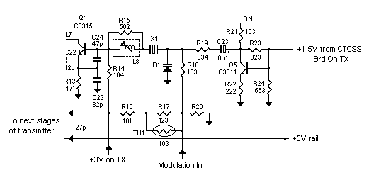

here's an example...
In the above FM transmitter circuit ( this is just the Colpitts oscillator stage) the modulation is applied to D1 which is a varicap diode. The modulating voltage causes the varicap diode to vary in capacitance slightly in proportion to the modulating voltage. This variation in capacitance allows the otherwise fixed freq of the crystal oscillator to change.
Again, the freq varies proportionally to the variation in capacitance which is proportional to the modulating voltage.

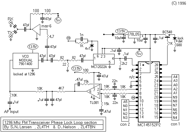

for a PLL system here's an example that a fellow amateur and I built and experimented with some years back on 1296MHz (23cm Amateur band)
the PLL consists of a VCO, upper left, a prescaler IC ( MC12022A) to bring the freq down to what the PLL IC (MC145152P2) could handle. The PLL chip produces phase difference voltages out of pins 7 and 8 and these are summed up in the Op-Amp (TL081) to produce an error correcting voltage that is fed back to the VCO module.
You can see that it at that point, between the Op-Amp and the VCO that we insert the audio modulation ( in the lower left corner of the diagram)

If I understand you correctly my question would be why would we need two pins and an op-amp to feed a voltage back to the VCO when presumably it could all be done in the PLL chip.
I find the whole thing a bit disheartening TBH. It seems to me that, for instance, you could take a 20 MHz crystal, feed it into a voltage controlled (1v = 1x, 5v = 5x, up to some limit) PLL chip, use a voltage divider with a potentiometer, drop a 1/10th frequency output pin on the PLL for low-end oscilloscopes and be done with the synthesis side. Instead we have 28 pin DIPs and datasheets whose target audience might as well be 15th century Mongolians.
Edit: it occurred to me as I was watching Hell's Kitchen that if you have a VCO locked at 1296 MHz, why do you need a PLL? I thought PLLs were mainly used for frequency multiplication.
some may well have that stage inside them, some dont, this particular one doesnt...
Do you not understand the purpose of a PLL/synthesiser system ?
PLL = Phase Locked Loop ... the loop in the above circuit is the one from the VCO to the prescaler to the PLL/Synth through the Op-Amp and back to the VCO
The VCO is only locked to a freq because of the action of the loop.
If it wasnt for that, the VCO would not stay on a fixed freq with any sort of accuracy. The PLL/synth chip, in this case the MC145152, is used to lock the VCO to a desired freq and to also be able to control freq (channel) changing
A lot of the newer LMX... series PLL/synth chips, by National Semi., are capable of much higher freq operation on their own as they have built in prescalers and will operate happily up to several GHz :smile:
cheers
Dave
