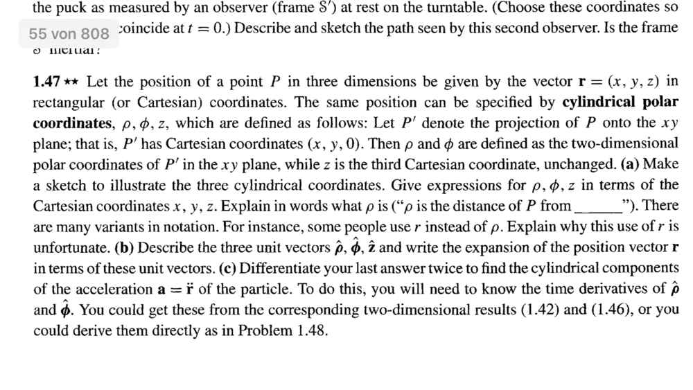

Ok. Slowly I am understanding. I have one last question I am not shure about.
In the picture you can see the actual exercise. Is it clear from this context, that it is possible to reduce the number of basis vectors? Would the solution to c be any different if i include the therm with phi?

It looks like you don't understand what part (c) is all about. In Cartesian coordinates tha acceleration vector can be written as
##\vec a=\ddot x~\hat x+\ddot y~\hat y+\ddot z~\hat z##
In cylindrical coordinates the same acceleration vector is written as
##\vec a=(\ddot \rho-\rho \dot \phi^2)~\hat \rho+(\rho \ddot \phi+2\dot \rho \dot \phi)~\hat \phi+\ddot z~\hat z##
Which description you use depends on the problem you are treating.
Example 1. A car accelerates in a straight line in along the ##x##-axis with constant acceleration ##a##.
In the Cartesian representation, you have to solve the differential equation
##\vec a=a~\hat x##
In the cylindrical representation "straight line" means ##\phi=const.##
##\vec a=\ddot \rho~\hat \rho## with the additional provision that ##\phi=0## in which case ##\ddot \rho=\ddot x=a## and ##\hat \rho=\hat x##. All this (in a more roundabout way) gives the same equation ##\vec a=a~\hat x##.
Example 2. A car goes around a circle of radius ##R## at constant speed ##v##.
Finding the components of the acceleration in the Cartesian representation without using the cylindrical (polar) representation is a mess. In the polar representation, ##\rho = R##, ##\ddot \phi = const.## which gives
##\vec a=-R \dot \phi^2~\hat \rho##
This is just the centripetal acceleration.
I hope these examples illustrate to you what's going on.

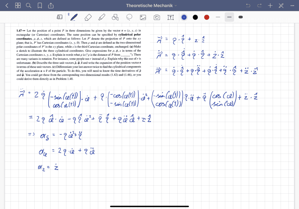

Here is my solution. Could be possible that I wrote down something wrong because I erased a lot and may have forgotten to erase something.

So Is it right to argue as follows (But maybe I am completely wrong):
In every 3D vector space there have to be three basis vectors to describe every possible vector. In the case of cylindrical coordinates the phi and roh basis vectors are both phi dependent. If we choose a fixed phi for both basis vectors, I need all three to describe every possible vector r. But in our case we don’t have a static phi. We choose phi always in that way, that the component of the phi-basis vector is zero (so the phi-basis vector does not appear). If this is true it would also be possible to construct every vector only with the roh-basis vector. (except in the origin).

Polar basis vectors are defined locally; whereas, Cartesian basis vectors are defined globally. In particular, owing to the singularity at the origin, polar basis vectors cannot be used in the way basis vectors are used in linear algebra: where every vector is essentially a position vector from the origin. You must stop trying to do this.
The polar coordinates specify a point. But, to do that, they require the x-y-z axes, as I described above.
Instead, you can think of a different vector space at every point. At the point ##(1, 1)##, for example, the local polar basis defines a vector space in which all local vectors are defined (velocity, momentum, acceleration, the electic field at that point etc.)
In any case, you must move away from the idea that polar basis vectors are there to define a position vector from the origin to a set of points in a plane or in 3D. They are not designed for this.
This is also a good time to move from the "abstract linear algebra" view of vectors to the "physical" view of vectors that you require for physics.
In fact, to jump ahead slightly but hopefully give you some motivation: in GR (General Relativity) the position vector disappears altogether and vectors become exclusively a local quantity!
