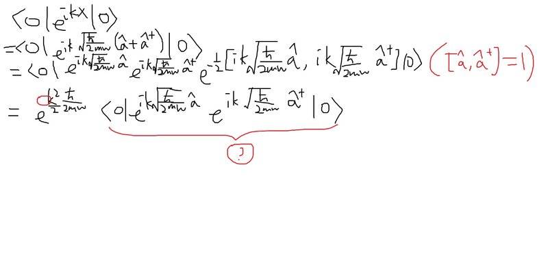

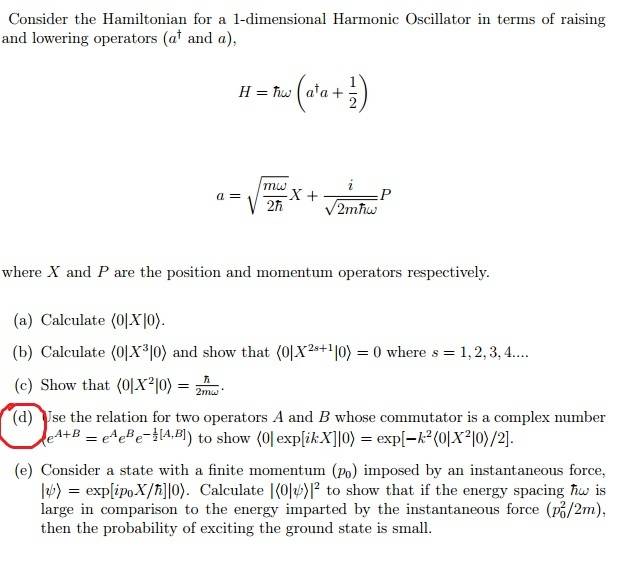

1.1st circle on the left : where did I miss a minus sign?
2. How to show that the last term is equal to 1?
Thanks!

I don't think you missed a minus sign here.
You'll have to see if it is, in fact, equal to 1.
You could try expanding the two exponentials in your question-mark expression and see if you can simplify it. Think about what happens when you act on the ground state with powers of a followed by powers of a.

Thanks, after expanding the exponential I recover the minus sign:smile:.
OK, good.
