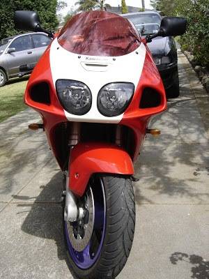

on the bike the engine sits perpendicular so the cylinders are equidistant from the front.the headlight assembly will be where the cone(s) will be put. have to work around the front suspension so I may need to do 2, each one feeding 2 cyl.
I have also contemplated layering the front end, similar to "<<" so it retains its shape and factory aero...or possibly using something on top of the radiator, as it catches air from above the tire but below the front end, the area that is spaced for the suspension travel, there will be excess air deflection above and below because of the pressure gradient as it hits the radiator but only a little bit passes through..

wow, 3psi... i know that it isn't exactly the same as a turbo, less heat, and turbo's have varying efficiency at different pressures/rpm but typically, at 3psi with a appropriately sized turbo, its not uncommon to see 25-30whp. I know aero comes into play, but with the inlet being at the front of the bike with no protrusion, i would think that once a pressure had built at the front, drag wouldn't be an issue as what was built up at the front would cause the excess air to streamline around the rest of the bike as if the headlights were still there. If both my assumptions are correct, that is a dramatic improvement, but I have to be skeptical because if some little know nothing like me could pick up that much power, someone else in the years of racing should have come up with something like this aswell.

Almost all sport bikes have ram air nowadays.
Read these 2 posts that contain an article from "Sport Rider":
http://www.kawiforums.com/1595315-post6.html"
http://www.kawiforums.com/1595319-post7.html"
Here there might be a good explanation of the limitation on the stock bikes:
http://www.hayabusa.org/forum/2102762-post4.html"
I think the problem is more one of engine tuning. IMHO, definitively worth a try, especially considering the low cost of the modification.
