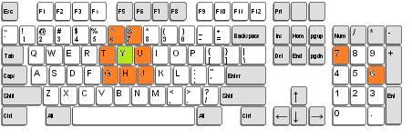

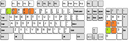

Im looking for someones help. Is there a standard methodology or known equation for generating a random alpha numeric serial or incremental, which does not allow two characters to be used in sequence to each other which are near each other on the keyboard. Iv attached two pictures below, which shows if you select a green key, the surrounding would not be allowed...
I have a vague memory this is what a number of banks do to generate account numbers in aid of reducing human error on typing.
The reason for this is at my company we are changing the way we create part numbers, but at present mistyping is a issue for ordering as all our part numbers are incremental i.e. LR000123, LR000124, LR000125.
Any help would be much appreciated.

I'd argue your looking at the problem in the wrong way. The real question should be why are you having people type in the part numbers instead of selecting them from a list?
That being said bank/credit card numbers do not avoid numbers being side by side on a keyboard or keypad. They likely use some form of error detection code, such as a Hamming Code, to define the numbers. Depending on how the Hamming Code is setup it can detect a certain number of errors in the code, and can even correct a smaller number of such errors.

Thanks. I can understand where your coming from but we have over 500k part numbers at present and this needs to be future proof... so a methodology that can run on for years to come, so a drop list isn't feasible. Even using a drop list for validation, if the keys are close we are still prone to "fat fingers" when typing in a part number.
Im thinking something like the KNN algorithm but a Non-KNN approach if that makes sense?

Having people type in a product number is not future proof. I never said all products needed to be seen at the same time on the list nor that the list had to be dropdown list. The system should allow for filtering to allow for users to narrow the focus down so that there are fewer products listed and hence you don't need to scroll through 500K+ entries. If I order a book from amazon I don't need to scroll through all X million book entries to find the one(s) I want, similarly there's no need for your users to do the same thing.
Anybody who does serious programming will tell you that user input, especially typing, is one of the most error prone ways of getting input. To future proof you want to get away from direct user input especially on critical area like what parts should be ordered.

A standard solution is to add one more digit to each number that is a checksum. It will detect 1 or even more typing errors and it will also detect swapping of digits.
It's for instance used for bar codes and the ISBN numbers of books.

Im fully on board with you and we are working to remove use input but with our global rollout it we looking to be years off :(, the issue is this type of solution you mention isn't available for us as we are using SAP and due to development policies we wouldn't be able to get the change through, so our only control is what number is generated and trying to address it there. Hope this makes sense.
