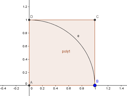

(a) Since the probability distribution is uniform in the square K(take it as ABCD here), there P(ξ,η) = 1 for all points inside the square(why? : because ∫∫P(ξ,η)dξdη with 0<ξ<1 & 0<η<1 should be 1 and marginal distribution for ξ and η are uniform)
Now we need to find probability of all those points lying below the arc ADB(to the opposite of e, poly1 side), since the distribution is uniform,
therefore, we will have P(ζ<1) = Area below Arc / Area of square = π/4 (area of square is 1)
(b)Now I hope that you can do this as its similar to (a), but if you face problem, feel free to reply
