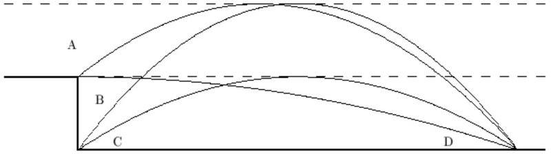

Rank the vertical component of the initial velocity of each projectile, greatest first.
n/a
I took the sine of the angles, the angles are ranked B>A>C>D you can see this visually as well as looking at the maximums. why isn't this correct?
n/a
What makes you think it's wrong?
The online program said i was incorrect. I solved that one, but now i am trying to find which one has the maximum velocity at the landing area
solved that one
A=C, right?
