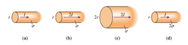

Rank in order, from the largest to the smallest, the current densities in these four wires, that have different radius and different electric conductivity

ja=I/πr2
jb=2I/πr2
jc=I/2πr2
Jb > ja > jc ...
i don't get how to use 2σ in order to find and compare the current density of d.
I know that
ρ=L/σπr2 but ...

Do the same analysis as you did for a, b, and c. (Is the conductivity relevant?)
not taking care of it the result is correct, but could you briefly explain why is not relevant ? Does it becomes relevant only for the potential difference ?
Don't overthink what they are asking for: The current density is current/cross-sectional area. The current is given in each case!
For a different question, the conductivity can be relevant. For example, the electric field strength within the conductor would depend on the conductivity. (But they didn't ask that here.)
