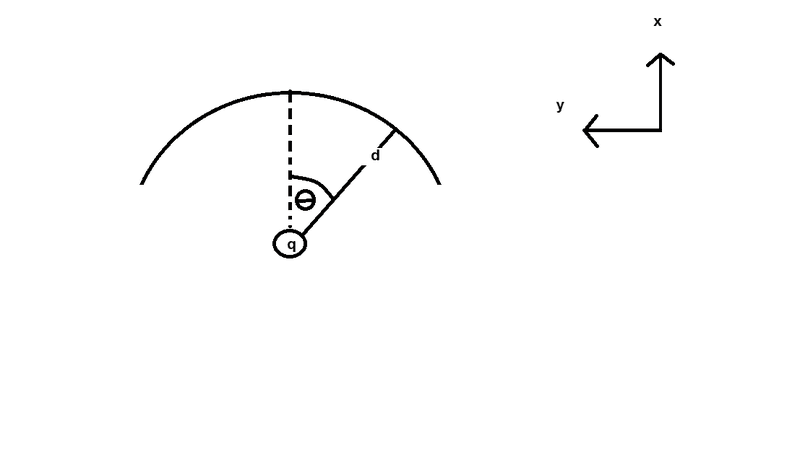

A point charge +q is placed near a curved, charged, insulating rod as shown at the left below. (I'll just draw it, I don't have access to a camera at the moment) The charge is placed near the center of the curvature of the curved rod. For each of the five cases A-E, the charge density on the rod varies according to the graphs, but the total charge is the same.
##F= K\frac{q_1q_2}{r^2}##
Not really sure, that's the only one I've used on this one.
First off, I'm not really sure what's expected on this, we've only had one class, and this is due tomorrow (if I could get help in the next few hours I'd love you long time), maybe I'm going too far with this, I don't know.
It looks like i have an arc of a circle radius d, and the arc goes from -60deg to 60deg with a charge at the middle (see diagram)
Due to symmetry, all the y components cancel so that's nice.
It doesn't really say what the charge density function yields, so I assumed that the area under the curve from a to b was the total amount of charge from a to b measured in coulombs. Is that too big of a jump?

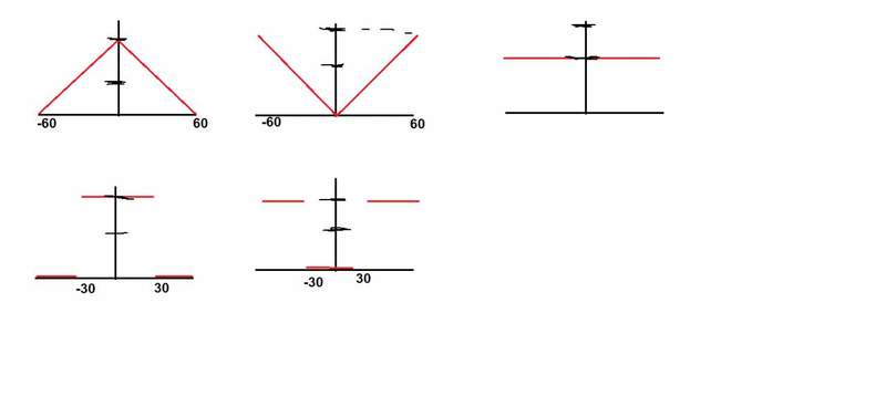

Let me provide an example:
Graph a is linear from -60deg to 0 and from 0 to 60. From -60 to 0 my density as a function of theta is ##\frac{1}{30}(\theta + 60)## and from 0 to 60 it just mirrors it back down to 60.
Don't ask me what the 2 at theta = 0 is, it's not labeled, it just goes up 2 ticks on the charge density (the graphs make me think this is potentially a qualitative analysis question, but I want to do it as quantitatively as possible.)

You don't seem to have attached the charge distribution graphs. Without those, it's hard to be sure, but I suspect that you don't need to do any integration as such, just apply a bit of logic.
But wrt your integral, it doesn't look right to me. If the charge density at angle θ is ρ(θ), what is the X component of the field at q due to the charge in the arc (θ, θ+dθ)?
I know that I don't HAVE to, (this might sound weird) I WANT to integrate. I've been trying to do this thing lately where I try to derive formulas for certain situation that I haven't really seen before. I'm sure there's a formula for this somewhere, but I thought it would be a good mind practice. I didn't attach the graphs. I'll do so.

The field would be ##\frac{K}{d^2} \Sigma Q_{\text{on the bar}}cos(\theta)##
where ##Q_{\text{on the bar}}## would be ##(\rho(\theta +d\theta) - \rho(\theta))d\theta##

Well I ended up just doing a weighted average. It would've been nice if I had realized (as one of my classmates pointed out to me after class) that the area under the curve was the same for all the graphs... Which means that every unit area carried the same amount of charge... I hate it when I miss something that simplifies things a lot:cry:

Now that I see the graphs, I see that it will not be hard to express the distributions algebraically, so integration is a reasonable approach.

No. ρ is a charge density. Why take a difference in nearby densities?

Yes, and its length is dθ. What is the density on the interval (remember, it is going to change very little over an infinitesimal interval)? So what is the total charge on it?

Yes. So can you figure out the algebraic expression for ρ(θ) for each graph, and execute the integrations?
Likes 1 person
Yea they're all pretty easy. Otherwise I would have probably tried a different approach. I already showed the one for A.
So I think I figured out where my confusion came from. I wasn't looking at charge density as charge density -.-
I was thinking total charge from one end to theta + d theta - total charge from the same end to theta ... haha
Thanks again, hopefully I won't make the same mistake again. :smile:
