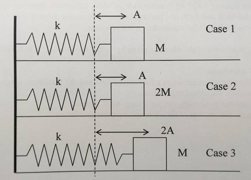

Rank the cases from maximum Kinetic Energy (KE) to lowest KE. State any ties. Briefly, explain your ranking.
Case 1 has mass M and amplitude A
Case 2 has mass 2M and amplitude A
Case 3 has mass M and amplitude 2A
1. [itex]E=\dfrac{1}{2}kA^{2}[/itex]
2. [itex]E=\dfrac{1}{2}mv^{2}[/itex]
k = spring constant (N/m) Newton/meter
A = amplitude (m) meter
v = max velocity (m/s) meters/second
I have the answer and it's 3 > (1 = 2)
Now, I've been trying to understand why? Equation 1 includes amplitude and equation 2 includes mass. All 3 cases include mass and amplitude. In equation 1, as amplitude increases, kinetic energy increases. In equation 2, as mass increases (by slower margins because of the half in front), kinetic energy increases. I don't get why case 1 = case 2? They both have the same amplitude, but case 2 has more mass than case 1. I think case 2 should have more kinetic energy than case one. Here's why, if I look at an example below.
let's say mass equals 4. (note: I'm ignoring velocity)
Case 1: E = 0.5(4) = 2 Joules.
Case 2: E = 0.5(2*4) = 4 Joules.
So mass is relevant when ranking the kinetic energy. Can someone shed light on something I may be missing? Thank you.

In all three cases you have the potential energy of the spring i.e. ##E=\dfrac{1}{2}kA^{2}## that converts to kinetic energy of the mass i.e. ##E=\dfrac{1}{2}mv^{2}## Now, does applying a different mass change the potential energy of the spring? Consider this for the tie between cases 1 and 2. For case 3 does the mass get higher energy from the spring or not?
I would say for the first part, that mass doesn't change potential energy because PE depends on spring constant (k) + amplitude (A). Okay, so I first look at PE, then I see if the mass is there and if not (and it's obviously not), then when converting from PE to KE (because the spring begins moving) it doesn't' change the KE? Am I understanding this correctly?
For case 3, I would say that the spring constant doesn't increase the energy of the mass. It does in case 2, the spring would need more k value (force) to push more mass (2M). Not for case 3, I believe.
The potential energy of the spring between cases 1 and 2 is the same. What has changed in case 2 is the mass of the body. So, when you release the body in this case what does this mean for the velocity of the body taking into account that mass has doubled?

In case 3 the amplitude is ##2A## as shown in the diagram. So, use the equation for the potential energy of the spring. Is the amount of higher energy transferred to the body higher or not?

##k## is a constant of the spring. So, what changes the potential energy is amplitude ##A##.

For both cases 1 and 2, the amount of energy transferred from spring to body is the same. So, what changes is the mass of the body (doubles) and the velocity of the body decreases such that the ##E## in ##E=\dfrac{1}{2}mv^{2}## stays the same. Just do the math to see what is the final expression. Now, more potential energy from spring means that more energy will be transferred to the body so if you release it, it will have more kinetic energy.

So we found the scale factors for the variables, but the kinetic energy omits the mass and we care for the amplitude?
No, the KE involves mass and velocity, but the problem is that changing the mass while keeping k constant changed the velocity, so we cannot use the usual KE equation to find the energy.
Instead, we use the fact that the total energy is constant in SHM. This means that that the peak KE (i.e. at force equilibrium) is the same as peak PE (i.e. when speed is zero). So we can use the PE equation to find the peak KE.
