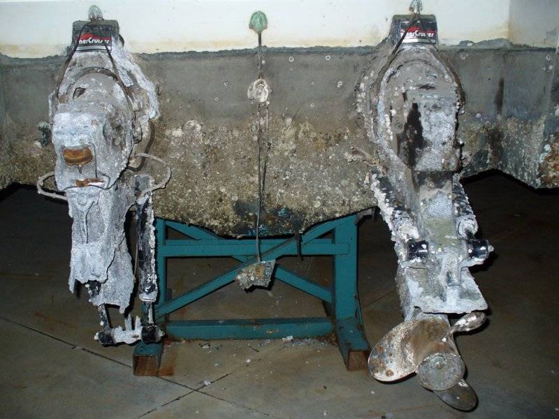

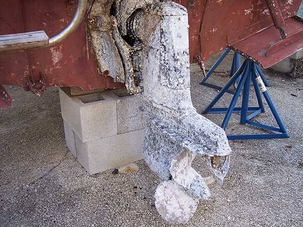

When there is a wiring error causing severe damage, I have seen results like in the picture in less than a week.
Or like this in a month

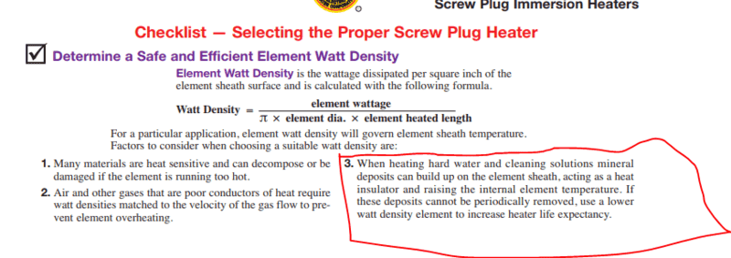

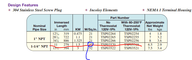

MARK JAMES said:
The heater is McMaster Carr # 3656K153, TEMPCO # TSP02245. Thanks!
https://www.tempco.com/Tempco/Resources/11-Process-Resources/ScrewPlugHtrCatalogPages.pdf
^^ your heater ^^
if you can stand the extra immersion length , this one has 37 vs 94 watts / in^2

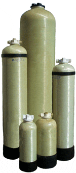

Sounds to me like the problem is with the water. I was involved with temperature and humidity controlled environmental chambers for the pharmaceutical industry. The humidity levels were maintained by injecting steam into the temperature controlled air stream. The steam generator tanks would get eaten up by just using "city water" so I installed deionization resin tanks to supply these steam generators.
image compliments of http://www.waterspecialties.net
Likes Tom.G, Asymptotic and jim hardy
This and the post by @Svein (https://www.physicsforums.com/threa...vise-to-puzzling-problem.964728/#post-6122723) point to the same thing, essentially mineral water being boiled at the heater element surface.
Additionally, the periodic addition of makeup water was mentioned. That indicates a loss of water, probably thru evaporation. That will evaporate the water but leave the minerals behind in an ever-increasing concentration. Oops! Closed system anyone?

Just a little update, currently Di water is used in the system and as we know the minute Di water touches all that stainless steel it grabs the elements it needs to return to normal ionized water. Our Di system is multi staged filtered as well.
More and more the "Element Watt Density" is looking like our strongest problem contributor. The stainless steel tank was the limiting factor for heater element size and we are looking at the 2" longer element in a tank redesign at this time. I will report back of course.
