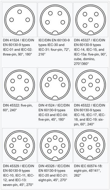

Have you not seen anything like the 4 pin with equal distance? Why is it so rare? Where to find it and included in USB cable like the following selling me for $400. I find it so expensive.

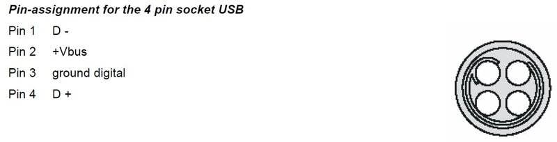

I don't own the equipment yet. Here is how the usb socket looks like.
Look up '4-pin M-DIN DC-power connector' or '4-pin power-din connector'
There are plenty of variations with thin and thick pins varied, or with slightly asymmetric placements, so you might not get the right one for first try but the product exists and available from bigger distributors (Farnell, Digikey, Mouser and such).
Ps.: you can also look for DIY solutions (with the type of connector mentioned) based on the device it'll be used for. If you are not familiar with the connector-jungle then this might be the best solution.

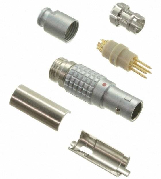

Google; circular USB connector 4-Pin Lemo
Likes Rive
Indeed, that is a Lemo connector so won't follow a DIN standard
Lemo is the name of well-known company that makes connectors that are frequently used on measurement equipment.
There is also a competing company called Fischer which makes very similar connectors, but I am pretty sure that is a Lemo
Your situation is probably exactly what the manufacturer intended: Take a 'standard' cable and change it so that most people will have to buy it from them.
Lemo connectors are never cheap but they are also very rugged and work well, meaning in many applications they are worth the price,
A simple 4-pin one shouldn't be too expensive and standards models are widely available. If you know how to solder you might be able to take a standards USB cable, cut off one end and replace it with the Lemo.
Note, however, that you need to pay attention when ordering the connector since they are highly customizable (by combining different connector parts); this is probably an off-the-shelf model, but if not you will need to spend some time browsing the Lemo catalog.
I found out the exact LEMO model that will be compatible is the LEMO FGC.0B.304 but I can't find stocks of this anywhere. Not even Digikey has this. Where else can you order these? At LEMO, they ignore any quote for simple item because they think it's not worth the hassle.
It's FGG.0B.304. Not FGC
Ok. Found it.

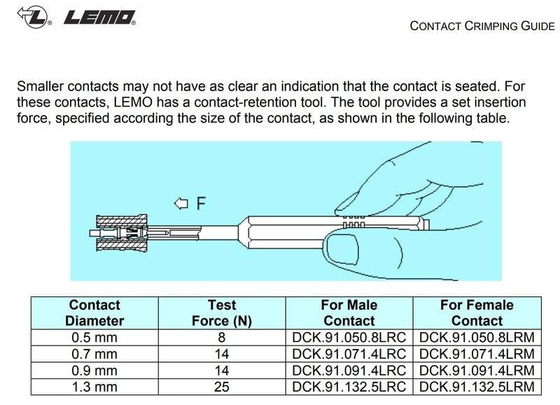

The description I saw on LEMO connectors was they use crimp pins. That is the large end of the pin has a blind hole along the pin axis.
The assembly process is to strip the correct gage wire, insert wire into hole in pin, then crush the pin using a special crimp tool. "Crush" in this case is to squeeze the pin like you would squeeze a hose to stop the water flow. This traps the wire in the pin, and if done correctly results in a gas-tight connection, almost a cold weld.
Soldering is an option, but takes a small tip on the soldering iron, fine diameter solder, and much experience.
For instance, in most (all?) crimp connectors the wiring end of the pins fit in a recessed hole in the connector shell. If you get solder on the outside of the pin it will not fit in the connector. If you know anyone who is well experienced with soldering small parts, get them to do it; whether by begging, paying, coercing.
It is possible to use pliers to crimp the pins but quite difficult to get it correct; better have a bunch of spare pins.
Good Luck!

Notice the wings of the pins. If they are not properly situated in the connector and you push against the socket pin in the equipment and the pin got push out backward, what would happen? But then isn't it the connector housing has retention screw at the back that can prevent the pins from moving backwards? This is my primary concern about the crimp connectors besides how to crimp it using long nose pliers. Yes, can you just use long noise pliers in crimping it and not investing on $500 crimping tools for just one project or crimping job?
Are you sure you can't find the solder version (where the pines are already fixed to the connector)?
They are definitely available (I have soldered many, many 4-pin Lemo connectors from various series over the years). That said, I understand you are looking at clones, so maybe they don't do solder connectors?
"FGG.0B.304" is just the first half of the part number, the full number includes a bunch of letters etc and one of these letters specifies if it is a crimp or solder connector. Again, see the Lemo multipole catalogue
I my experience, using anything except the correct tool for crimped connectors is not a good idea; you often end up with bad contact between the wire and the connector and/or pins that keep getting coming loose
Also, if you are using crimped connectors it is vital that you use the right wire diameter or it won't work regardless of the tool you are using.
Usually, crimp pins can be soldered with some practice. As long as there is no solder on the outside of the pin, they will fit.
Crimping provides uniform result even with low skill, while acceptable soldering requires practice => in the industry, crimping won. But soldering is still valid.
But, doing crimping with common pliers is a hack at best.

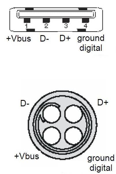

I just want to connect a USB 2.0 male to a LEMO end with the following pinouts:

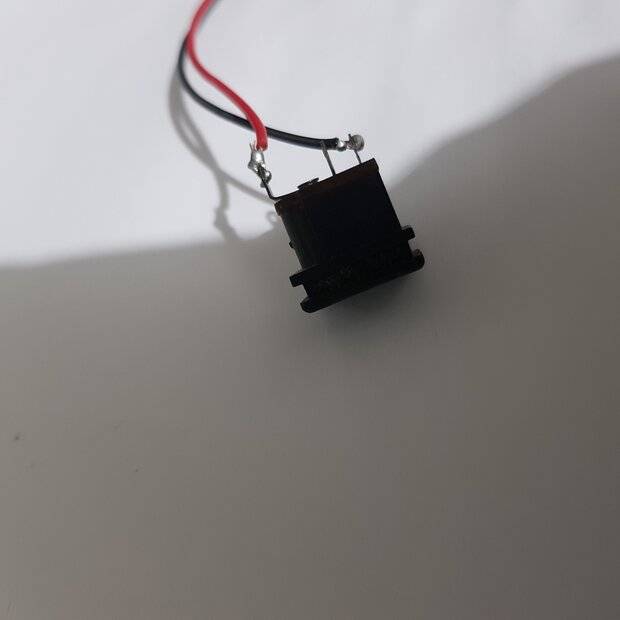

My soldering is very poor. This is the best I can do for a dc jack. Can anyone please help me solder the USB 2.0 cable to the LEMO?

There are two possibilities for the condition of those solder connections.
1) The connector pins may have been dirty or oxidized. Any dirt, corrosion or oxidation Must be cleaned off of surfaces because it blocks the solder from getting to the metal.
2) The connector pins may not have been hot enough. To get a good solder joint the pieces themselves must be hot enough to melt the solder.
After the parts are clean, a good approach is:
PROCEDURE
Before you start. put a small amount of solder on the tip.
The solder iron the tip should have an even coating of solder. If the solder balls up into clumps or doesn't cover the tip, then the tip is dirty/oxidized. clean it by wiping on a wet sponge, (natural sponges work best, the common synthetic ones you buy in the grocery store tend to melt and leave a mess on the tip) add some solder and try again. This keeps the tip from oxidizing, instead the film of solder oxidizes.
When you are ready for the next joint, wipe the tip on a wet sponge (or some wet paper towels folded up).
Then put a little bit of solder on the tip.
1) have a little bit of fresh solder on the solder iron tip
2) put the solder iron on the largest part where you want the joint
3) feed the solder onto the part that you want to solder, not onto the iron.
when the part starts to melt the solder you can, if needed, move the iron around to get a good solder coating where the joint will be (this operation is called "tinning" but is not always needed on new, clean parts)​
4) assemble the wire to the joint
5) put the solder iron on the joint so it is in good contact with both parts of the joint
6) feed solder to the spot where the joint and solder iron meet
(it doesn't take a lot of solder, if the wire and joint area are covered enough that there is a fillet of solder where they meet they are good. for instance the Military spec for soldering states that you should be able to see the outline of the wire; most of us often use a little bit more)​
7) when enough solder flows, remove the solder and the iron
DO NOT MOVE THE CONNECTION UNTIL THE SOLDER SOLIDIFIES!
If the connection is disturbed before the solder solidifies, the solder will crystalize (look grainy and perhaps have a slightly gray color) and be very weak. This is called a "cold solder joint."
Then put a little bit of solder on the solder iron tip and set it down.Hope this helps!
