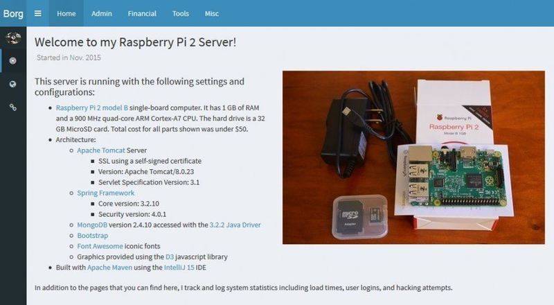

I got the OS installed and have connected using HDMI to a TV and Putty, and Filezilla from my laptop. Installed Tomcat, started it, opened a firewall port and checked it from my phone. Things are working well so far.

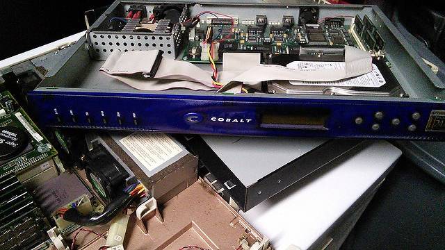

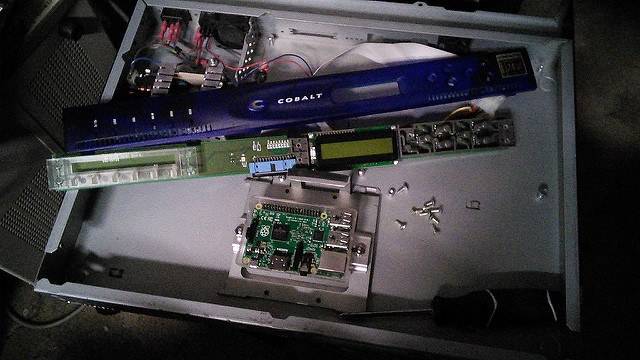

I'm using a old COBALT RaQ-2 case to install an RPi2 (or two) for a music server now.
Original. (with dead Sparc Station 10 for another PI retro case project)
Rebuild with PI card installed on the original HD tray. Need to interface the original LCD and buttons to the GPIO on the PI.
I'm in the process of writing a panel driver for Raspbian Jessie as the OS to display and control
the music selections while using Icecast2 and MPD (Music Daemon Player) to play music on a NFS mounted volume
from the main file server.

Another update on the server. Although I had gotten the two way certificates to work, I couldn't access it from a mobile phone because the certs were built from my own certificate authority. So, I've opted for one-way certificates with Spring security and multiple levels of validation. All pages now check a whitelist of top-level US domains, followed by blacklisted IP addressses within the whitelist, country of origin checks against the IP address, and lastly, a user login screen that validates against users in a Mongodb database on the Pi. I still want to add a check for multiple login failures from unknown IP addresses.
Most of the projects that I've worked on in the past have made security a priority but always after coding a large chuck of the program first. It's nice to build a server for a change that builds in security first. Now I can get to the business of building the tools without wondering who might be trying to break in.

Still coding away at the server. Building the architectual framework has taken a lot of time but it is coming along nicely.
As the note at the bottom states, I am tracking hacking attempts and displaying them in my administrative page.

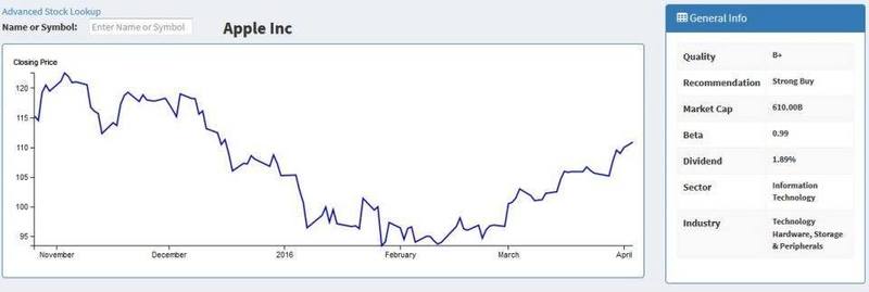

The beginnings of a financial page are in place.
