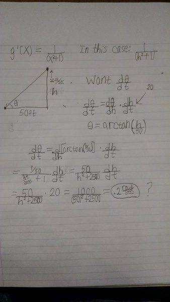

A spectator is standing 50 ft from the freight elevator shaft of a building which is under construction. The elevator is ascending at a constant rate of 20 ft/sec. How fast is the angle of elevation of the spectator's line of sight to the elevator increasing when the elevator is 50 ft above the ground?
Derivative of arctan
g'(x) = 1/[(x^2)+1]
h=height
I don't know how to use latex.
I used implicit differentiation. Since the elevator is moving at a velocity of 20 ft/sec, I plugged that in for dh/dt. Because they wanted me to use the derivative of arctan formula, I'm assuming the input is h/50 (y/x). After I plugged in h/50 into the formula, I plugged in the height they gave me, 50, into h. I multiplied that by 20 (dh/dt) and got 0.2 rad/sec.
Did they want me to find the time when the elevator was 50 ft above the ground first?
Also I apologize for the small writing. It's arctan(h/50).
I don't think the time when the elevator is 50 ft high is relevant.
Am I allowed to ask if the result I got is correct? If not, that's fine.
I don't see anything wrong with your work.
Likes Amrator
The result looks to be correct.
Working it a somewhat different way, I get the same result.
Likes Amrator
Alright. Thanks for the help, guys. I really appreciate it.
