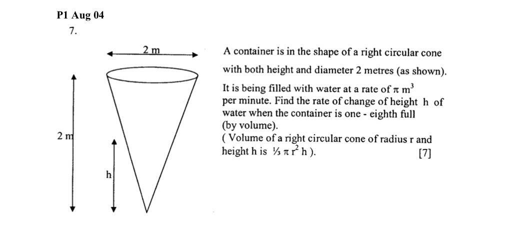

The ans is 4. Could someone please help..thanks in advance. :)

Hi Milly! :)
Can you set up a formula for $V(h)$?
What is the volume when the container is filled for 1/8?
And what is the corresponding height?

Suppose the cone is filled up to some height $h$.
What is then the radius of the cone as far as it is filled?
Can you substitute that radius in the formula $V=\frac 1 3 \pi r^2 h$?
That will give you the volume $V(h)$ as a function of $h$.

When the container is full, the height is 2 and the radius is 1, which is half of the height.
If it is filled up to some height $h$, the radius will be half of the height.
So:
$$r = \frac 1 2 h$$
What do you get if you substitute that in the volume formula for a cone? (Wondering)

$\frac{{h}^{3}\pi}{12}$...
Good!
Can you find $\d V h$ now?
And how might you get to $\d h t$, which is what the problem asks for?
Ohhh i got it$\frac{{h}^{3}}{12}$$\pi$ Is equal to 1/12 $\pi$ So h is 1.
