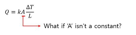

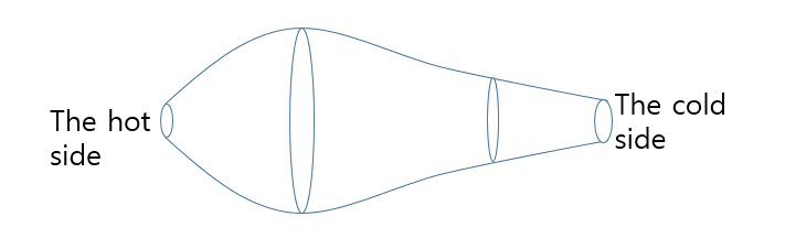

When we measure 'the rate of conduction heat transfer'=Q , we assume that the hot side and the cold side's area are same. But if the both side's area is different to each other, how can i know the rate of conduction heat transfer?
like below figure.
Would you like to help me?? Thanks.

Please provide a diagram illustrating the kind of geometric arrangement you are referring to.

I edited it.
As said, conductivity is a property of the material, not iys geometry.
So you prob. meant conductance or resistance.
Just calculate the reisitance of a differential cross-sectional volume & integrate.

@Chestermiller is the subject matter expert here, but it seems to me that you would need to make some assumptions of uniformity and directionality for the heat flow before a scalar figure for resistance across a cross-section becomes meaningful.
For a reasonably long and thin object, such assumptions may be reasonable, but it is good to be aware that one is making them.
Likes etotheipi, Chestermiller and russ_watters

For the figure the OP provided, what i suggested would be appropriate.
Of course, you can be infInitely picky, such as heat lost/gained along the figure - but this is supposed to be introductory physIcs. Sturm-Liouville is not yet encountered, for example.

I agree with @jbriggs444. If the cross sectional area were changing very gradually (like toward the right side of the figure, but not like toward the left side of the figure in post #1), you could write $$Q=kA(x)\frac{dT}{dx}$$where Q is the rate of heat flow (independent of x) and A(x) is the local cross sectional area. This would integrate to $$Q=k\frac{\Delta T}{\int_0^L{\frac{dx}{A(x)}}}$$
If the geometry does not vary gradually, one would have to solve the 2D or 3D heat conduction equation, a partial differential equation.
