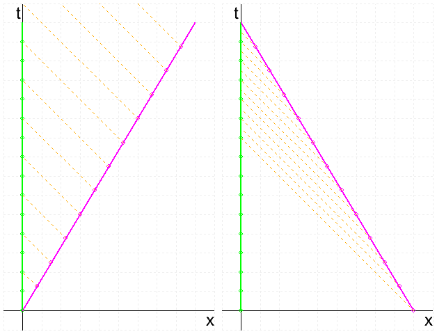

Below is a pair of space-time diagrams. These are just displacement-time graphs with the time axis pointing up the page (the grid is at 1s intervals) and the position axis across the page (the grid is at one light second intervals).
They both show an observer who is stationary in this frame (green line, always at the position x=0) receiving light pulses from a source (purple line) moving at 0.6c. The dots on each line mark when their clocks tick - the green dots occur every second, and the purple dots every 1.25 seconds due to time dilation. Light pulses (dotted orange lines) are sent every time the traveller's clock ticks.
In the left graph, the purple observer is moving away from the green observer. The green observer receives a pulse every two seconds.
In the right graph, the purple observer is moving towards the green observer. The green observer receives a pulse every half second.
One can explain why the Doppler factor is what it is by observing that the purple source emits a pulse every 1.25s (according to the green observer), but moves 0.75 light seconds in that time, so the flight time for each pulse changes by 0.75s compared to its predecessor. Pulses therefore arrive every (1.25+0.75)s or every (1.25-0.75)s.

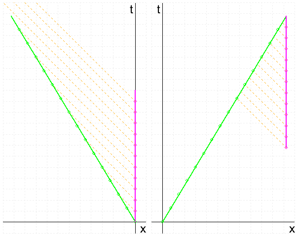

But what does this look like to the moving observer? I've re-drawn the space-time diagrams switching to the frames where the purple observers are at rest. In these frames, the green observer is doing 0.6c away from or towards the emitter.
Again, in the left graph the observers are moving apart; in the right graph they are moving together. Again, you can see that the ticks on the moving observers' lines occur at 1.25s intervals, while the stationary observers' ticks occur every 1s. But in these frames, the period of time when the green observer's clock is ticking is longer than the purple observers; it either started early or finished late. In other words, the relativity of simultaneity comes into this as you suggested.
Does that help?
Ibix said:
Does that help?
This would greatly help ! I didn't read the whole post because I think I concluded my problem from the first part, So please tell me if I'm wrong with the following in order to re-read your post
I don't necessarily see the calculated time dilation with my eyes, because light takes time to travel and in that time the moving source" from my perspective" has changed its position when shooting the second pulse. But I'm sure that the moving clock is dilating . So in your diagrams I will see the 2 pulses with .5 between them, but they were shot with 1.25 seconds between them from my perspective however I don't see or experience the 1.25 seconds.
