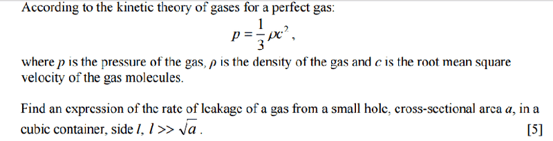

Here http://imgur.com/a/4LRM6
2. Homework Equations
The equation is given int he question
gas will stop flowing when the pressure inside the gas is equal to that of the surroundings. I calculated the final mass of gas inside the cube. Then i calculated the change in mass of the gas and i got that to be c^2*L^3/3*(1/p-1/Po) then i divided by t and converted L/t=c. However i don't think this is correct as i don't see why the rate of flow of gas should be constant and also my answer seems to be independant of a which seems counter intuitive.
Your approach looks questionable.
You're not interested in what happens after pressures equalize. You're interested in the outflow of gas due to the delta in the partial pressure between the inside & outside. The assumption is that outside the box the partial pressure of the gas is zero. So I would consider the component of gas molecules' velocity normal to the side containing the hole, then velocity times area times density = outflow rate.

I agree my approach was dumb. I figured out that the rate flow is proportional to the density, however I can't seem to figure out what to do from there since the density is changing. I can figure out the change in density of the gas in a time t and then I'm stuck

other hand I was able to derive an equation for the no of moles of gas left in the cube as a function of time. ( I got an exponential decay) but I guess this doesn't quite help me

EDIT: thinking more about it I guess since the size of the box was given we should compute density ρ and flow rate as functions of time.
But the approach is the same: compute the normal velocity as a function of ρ, then compute flow rate, then ρ decreases with flow rate which reduces flow rate etc. Calculus involved.
Also I would forget no. of moles. Stick with kg since you're given the expression for the molecular velocity as a function of density (assumed in in kg/m3.)
Looking at this some more, it appears that not enough info is given.
It's obvious that you need to solve for initial density ρ0 and molecular velocity c0 somehow. But even if initial pressure p0 were given, which it isn't, that does not suffice to determine ρ0 and c0, obviously. And even if temperature were given, that would give us number of moles but not density.
So i would proceed by ignoring the given formula, assuming initial values ρ0 and c0, then solving for flow rate dm/dt which will be a function of t.

I think the size of the box was specified as l merely in order to write l>>√a. I don't think it is supposed to feature in the answer.

However all these approaches seem fine but, there is a next part to the question and this makes no sense unless what its asking me to calculate is the INITIAL flow rate!
A cylinder that contains helium has a diameter of 300 mm and a length of 1.5 m. The pressure of the gas in the cylinder is 10 atmospheres above the ambient air pressure. There is a small hole in the piston, diameter 2 mm. Calculate the rate of fall of pressure in the cylinder assuming that the expansion is isothermal.
and the funnier thing is that the answer kind of needs to be independent of the velocity of the particles which is weirder
