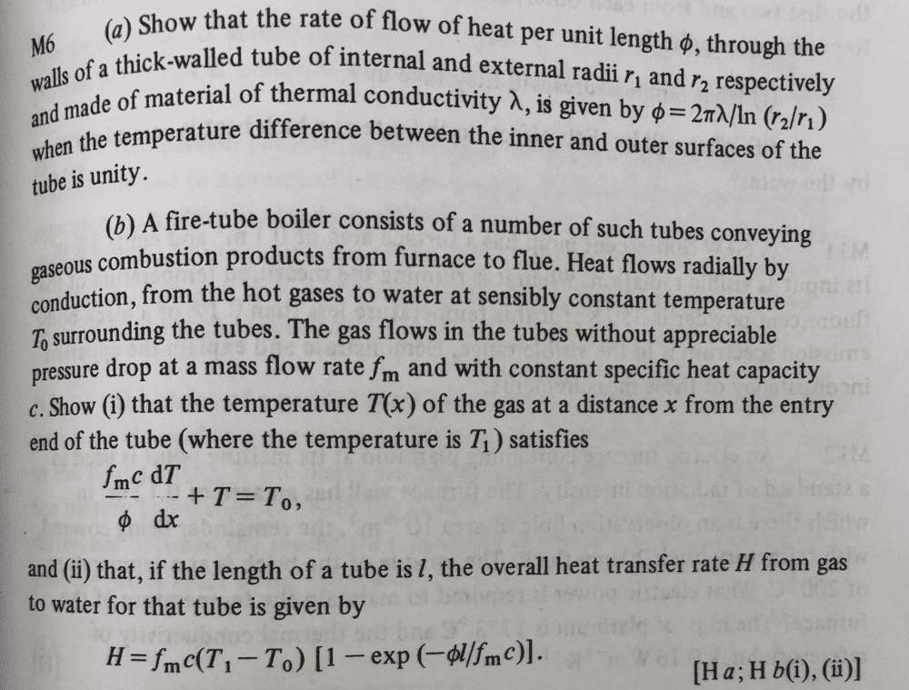

Please see the picture below
Rate of heat conduction = constant
I have solved the first 2 parts.
For the 3rd part, I have obtained the equation:
T(x) - T0 = (T1 - T0)e^(-Φx/fc), where f = fm in the question.
How do I obtain that expression for H?
Thank you!
Consider a section of pipe (x, x+dx). What is the rate of radial flow of heat there?
Thank you so much for this! I have now obtained the answer
