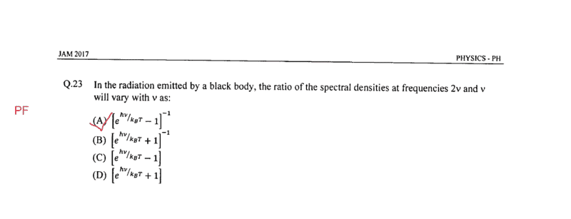

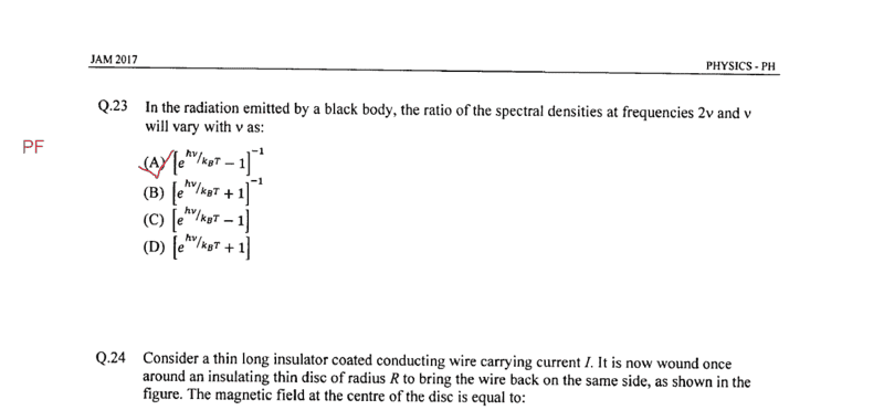

The energy density is given as ## u = \frac { 8 \pi {\nu }^2}{c^3}~ \frac { h \nu} {e^{ \frac { h\nu}{k_B T}} – 1}.##
EDIT : I put the constant C.
## \frac { u( 2 \nu) } {u(\nu)} = C \frac { {e^{ \frac { h\nu}{k_B T}} – 1} }{ {e^{ \frac { 2h\nu}{k_B T}} – 1} } ##
Where C is the appropriate constant.
Is this correct?
Pushoam said:
The energy density is given as ## u = \frac { 8 \pi {\nu }^2}{c^3}~ \frac { h \nu} {e^{ \frac { h\nu}{k_B T}} – 1}##.
## \frac { u( 2 \nu) } {u(\nu)} = \frac { {e^{ \frac { h \nu}{k_B T}} – 1} }{ {e^{ \frac { 2h \nu}{k_B T}} – 1} } ##
Is this correct?
The formula is correct (apart from a constant factor), but you have to simplify it and figure out which option it corresponds to. Note that ##e^{ \frac { 2h \nu}{k_B T}}=\left(e^{ \frac { h \nu}{k_B T}}\right)^2##
Thanks for this insight.
## \frac { u( 2 \nu) } {u(\nu)} = \frac { {e^{ \frac { h\nu}{k_B T} } – 1} } { \left ({e^{ \frac { h\nu}{k_B T}} – 1}\right ) \left( {e^{ \frac { h\nu}{k_B T}} +1} \right) } ## ## = \frac1 {e^{ \frac { h\nu}{k_B T}} +1} ##
So, the answer is option (B).
Yes :)
