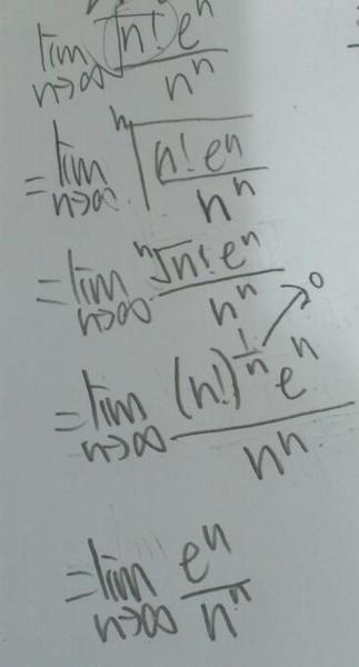

Sorry, I don't know how to find interval of convergence by root test.:frown:
This is my attempt.

The nth root refers to the whole an.
[tex]\sqrt[n]{\frac{n!e^n}{n^n}}=\sqrt[n]{n!}\frac{e}{n}[/tex]

Does the whole limit go to 0?
I don't know if the [itex]\sqrt[n]{n!}[/itex]is greater than n?

Use Stirling's Formula to see what is happening.

n! < nn, so ##\sqrt[n]{n!} < \sqrt[n]{n^n} = n##
Do you see why the first inequality is true?

No. (You can cheat by inputing it to wolframalpha.com)
