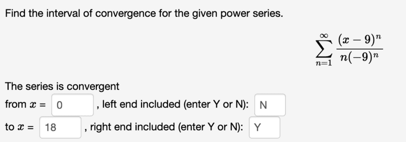

The series is this:
$$\sum_{n = 1}^\infty \frac{(x - 9)^n}{n(-9)^n}$$

It's a power series at the point ##a=9## whose radius of convergence ##R## is given by
<br /> \frac{1}{R} = \limsup _n \frac{1}{\sqrt[n]{n9^n}} = \frac{1}{9}.<br />
Hence, interval of convergence contains ##(0,18)##. For ##x=18## we get ## \sum \frac{(-1)^n}{n} ##, which converges. For ##x=0## we get divergence. So the interval of convergence is ##(0,18]##.
