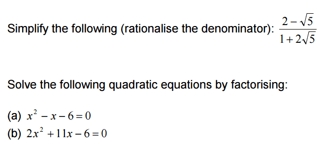

For the first question I know you have to multiply the conjugate of the denominator so it would be (2 - √5)/(1−2√5) x (1−2√5)/(1−2√5) but I'm not sure how to actually do that.
For the second question. I have that -3 x 2 = -6 and -3 + 2 = -1 which fits the sum. I think this is correct.
for this second part of the second question, I'm not sure how to solve this as I don't see any factors of -6 which when added together = 11. [/B]
The first thing you need to do is to be very careful to get your signs right, which is not happening in the bit I quoted. Where has the 1+2√5 disappeared to?
Next, when multiplying the first fraction by ##\frac{1-2\sqrt{5}}{1-2\sqrt{5}}##, just make the result a new fraction in which the numerator is the product of the numerators and the denominator is the product of the denominators. You know: $$\frac{a}{b}\times\frac{c}{d}=\frac{a\times c}{b\times d}$$.
You won't be able to use that simple rule, because the ##x^2## has a coefficient other than 1.
Instead set ##(2x+a)(x+b)## equal to the quadratic. Expand the brackets and then work out what ##a## and ##b## have to be to make the equation true for every possible value of ##x##.
