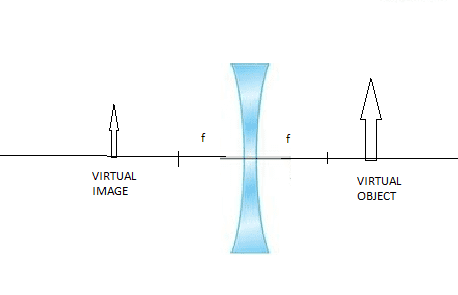

Draw the ray diagram of the case of a diverging lens where both object and image are virtual, that is ##f<0## , ##p<0## with ##p<f##
I did not find this particular case of ray diagram in any textbook so I would like to know where to find it or how to build it on my own.
Watch this .
It might give you ideas you can apply to the diverging lens.
