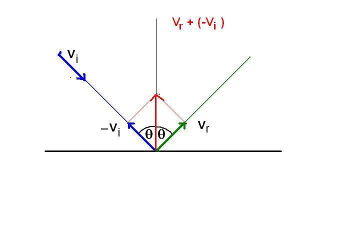

Pranav-Arora said:
The vector for the light ray traveling parallel to x-axis is ##-2\hat{i}##. The incident ray and the reflected ray make equal angle with the normal passing through (2,2,0). The vector associated with the normal at (2,2,0) is ##-2\hat{i}-2\hat{j}-\hat{k}##.
Vi has to be a unit vector, why do you multiply it by 2?
Remember the figure demonstrating reflection. n, the normal vector points outward. Your normal points inward, toward the centre of the sphere.
Vi points toward the surface and Vr points away from it. θ is the angle less than 90° enclosed by both -Vi and Vr.
Otherwise your method is all right, but you need to use the condition that both Vi and Vr are unit vectors. And it would be much easier to use the relation Vr-Vi=2cos(θ)n (where n is the normal unit vector).
ehild

Pranav-Arora said:
Okay, I will rewrite everything.
##\vec{v_i}=-\hat{i}##, ##\displaystyle \vec{v_r}=\frac{x\hat{i}+y\hat{j}+z\hat{k}}{\sqrt{10}}##. Referring to your sketch,
[tex]\vec{v_i}\cdot \frac{(2\hat{i}+2\hat{j}+\hat{k})}{3}=\cos \theta[/tex]
[tex]\Rightarrow \cos \theta=\frac{-2}{3}[/tex]
Look at my sketch more carefully. θ<90° is the angle between the incident ray and the normal. [itex]-\vec v_i\cdot\vec n=\cosθ=2/3[/itex]. The angle between vi and the normal is 180-θ.
ehild

Pranav-Arora said:
Thanks ehild! :smile:
The correction gives the right result.
Splendid :biggrin:
Now, you can see an other hint on my sketch. (It is similar to voko's method.) The red vector is -vi+vr=2ncosθ. n=(2i+2j+k)/3, cosθ=2/3, so vr=(xi+yj+zk)=2ncosθ+vi.
ehild
Typo?
ehild

Pranav-Arora said:
Typo?
Why? The vertical components of both vr and -vi are cosθ. They add. The sum points in the direction of the normal, so it is multiplied by the normal unit vector.
whild
ehild
Ah sorry, I misread it. The minus sign and v_i are shown in separate lines here so I did not notice it. :redface:
