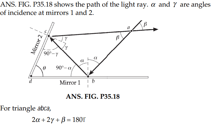

For this problem,
The solution is,

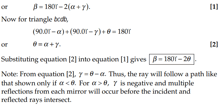

I don't understand how if ## \gamma < 0## then there will be multiple reflections? I don't understand how ##\gamma## can be negative.
Many thanks!

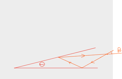

Thank you for your reply @haruspex!
Like this?
Many thanks!
Like this?
Many thanks!
First reflection looks fine, the second impossible. How do you figure out where a reflected ray goes?
Likes member 731016
Using the law of reflection
EDIT: Apologies, the diagram is not to scale. Let me know if you want me to redo it and I will use a better program (Microsoft paint instead of snip tool)
Many thanks!
Which states …?
Angle of incidence is equal to angle of reflection
Many thanks!
Many thanks!
But what you drawn for the second reflection is nothing like that.
Draw the normal to the mirror where the ray hits it. The incident ray makes some angle theta to that normal. The reflected ray should also make angle theta to the normal, but on the other side of the normal.
Likes member 731016
I will draw another diagram. Sorry if my replies are a bit slow
Many thanks!
