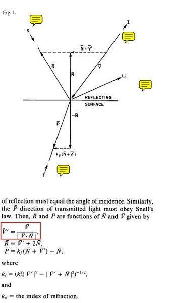

As many of you may know, ray tracing was first introduced by Turner Whitted in 1979 in a paper titled "An improved illumination model for shaded display" (can be found on ACM digital library).
On the 2nd page, in part 2 (Improved Model) there are a number of fairly simple vector calculations, unfortunately I can't understand what is vector V' (please refer to the attached screenshot), and why is it scaled by | V . N | ... I would like to ask for your thoughts on this :)
Thanks !
P.S.: unfortunately I can't attach the paper to my post, it is copyrighted by ACM and I think it would be illegal to do so.
EDIT: found a link to the paper from Drexel University here

The diagram shows you the vector (N + V'), as the "horizontal" dotted line ending at the top of the N vector.
So V' is the third side of the triangle with the other two sides N and (N+V'). Ini other words, V' is the V vector scaled to be the same "vertical height" as N.
Earller N was defined as the unit vector (i.e. its length=1) normal to the surface.
So |V.N| is the length of V, times the cosine of the angle between V and N.
