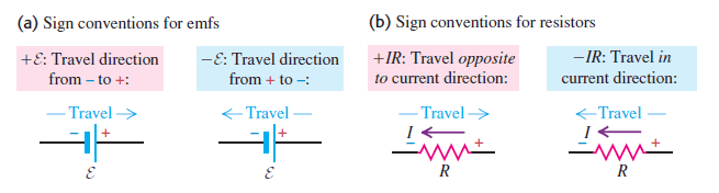

If I "go" in the direction of the current, then the potential difference over both resistors are negative whereas it is positive over the capacitor, hence
[tex]V(t) - V_{R_{1}} - V_{R_{2}} = 0 = V(t) - R_1 I - R_2 I[/tex].
Which I can rewrite using the time derivative of Q (3 and 4 from above)
[tex]= V(t) - (R_1 + R_2)\frac{dQ}{dt} = V(t) - (R_1 + R_2)C\frac{dV(t)}{dt} = 0 \implies \frac{1}{(R_1 + R_2)C}V(t) - \frac{dV(t)}{dt} = 0[/tex].
By solving this differential equation, I get
[tex]V(t) = V_0e^\frac{t}{(R_1+R_2)C}[/tex]
which is wrong, because the voltage should decrease over time, so a more logical solution would be
[tex]V(t) = V_0e^{-\frac{t}{(R_1+R_2)C}}[/tex].
Is there something I have overlooked? Is Kirchhoff's law setup incorrectly (sign conventions)?
Any help is appreciated.
VC(t) + VR1(t) + VR2(t) = 0 is the equation
Yes, I realize that has to be true for it to be correct, but I am just confused about the signs. My book (Sears and Zemansky's) mentions some sign conventions in relation to Kirchhoff's voltage law (see picture).
So why is it + rather than - ?
You have 3 passive elements in the circuit and no driving emf. Don't know what confuses you.
nossren, have you considered what sign should be associated with dV/dt on the capacitor? Will V be increasing or decreasing given the direction of the current flow?
