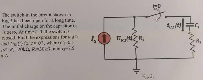

so when t=0, the capacitor is a closed circuit.
The Req of the circuit is (20k)(30k)/(20k+30k)= 12000 ohms.
U = I Req = (7.5x10-3A) (12000 ohms) = 90 Volts
so there is a voltage drop of 90 volts across the 20k resistor (R1), when t=0.
RC= Req C = (12000 ohms) (0.1 x10-6F) = 0.0012 sec
∴ UR1= Uo (e-t/RC) = UR1= 90V (e-t/0.0012)Ok, so then the current flowing through the capacitor would be the same current flowing through the 30k resistor when t=0.
Using current division, 7.5x10-3A [20 / (20+30)] = 0.003 A
iC1 = io (e-t/RC) = (0.003A)(e-t/0.0012)
This is my final answer, I've erased my initial attempt as it was wrong. Could someone verify if this is correct?

The capacitor is initially uncharged. The voltage across it is zero at t=0. That's like a short circuit, not an open circuit.
If it is a short circuit, then my drawing is wrong? :(
So a capacitor only behaves as a open circuit when it is fully charged?
Using current division, 7.5x10-3A ( 20 / (20+30)) = 0.003 A
RC = (30,000)(0.1 x 10-6) = 0.003 seconds
iC1 = io (e-t/RC) = (0.003A)(e-t/0.003)
or is RC not 0.003 because I had to use Req of the circuit before capacitor became fully charged?
This means voltage across R1 is exponentially decreasing. Is it? Think about the steady state of this circuit. Which quantities become zero in the steady state here?
so the capacitor has increasing voltage across it over time, and decreasing current across it, so when current decreases, R2 will have less current passing through it... and since we have a current source, we have a constant flow of current flowing through it, therefore all the current (or most) overtime will have to flow through R1 once the capacitor is fully charged (where it becomes open circuit)
applying ohms law, the voltage drop across R1 should be increasing.
Yeah... I'm having a harder time understanding/remembering the equations than understanding the concepts. :H
The voltage drop across R1 should be (7.5 mA) (20k ohms) = 150 V.
but I'm having trouble obtaining an equation that equates to 150V when t → ∞

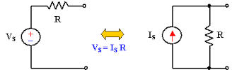

Right. Have you studied source transformation? It would be easier.
No, I'm in an intro class, and we haven't even (or just started) AC circuits.
Ok but source transformation means converting current source into voltage source.
You can replace a current source of magnitude I with parallel resistance R with a voltage source of magnitude I*R with the same resistance R in series. This way, you'll end up with a simple RC circuit with two resistors in series with a capacitor and a voltage source.

Initial current through the capacitor will be 30mA and that through R1 is 20mA, as you calculated earlier. Now, voltage across R2 decays to 0 exponentially and voltage across R1 increases to 150V exponentially. Also, capacitor voltage increases exponentially to 150V. Using the source transformation, you'll get the expression for ic(t). You can use it in the original circuit to find i1(t) and U1(t).

UR1(t) = [Is - IC1(t)]/ 20kΩ
Plugging in IC1(t)] from what I found before:UR1(t) = [Is - io (e-t/RC) ]/ 20kΩ = [Is - (0.003A) (e-t/0.0012) ]/ 20kΩ
This is the right expression.
The time constant is incorrect.
No. The time constant considers both R1 and R2. How are they connected when you open the current source?
the capacitor, and both resistors would be in series.
Right! So what would be your time constant?

But the current (and rate of change of current)through the capacitor also depends on R1. Change R1 and verify. Current division changes with R1. Voltage across the capacitor also depends on R1. Also, using source transformation, the circuit will look like this:
150V source in series with 20k and 30k and the capacitor. This means R1 and R2 are in series when it comes to time constant calculation. Open the current source and short the voltage source and see how the elements are connected.

ok, having done some reading on source transformation, i think the part that probably confused me a bit more than it should have, was the source was a current source and not a voltage source.
So yes, after source transformation, it would be a 150 volt battery in series with 20k and 30k resistors, and the capacitor.
then Req would be 20k+30k
