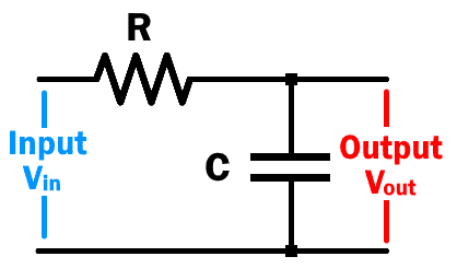

Hey Everyone,
I am trying to gain a level of fundamental understanding of an RC circuit sine wave response through the mathematics and was wondering if someone could help me work it out.
Fundamentally a sine wave is represented by the equation y=-ky'' . When a sine wave is used as the input of an RC low pass filter, you get a sine wave out (just phase and amplitude shifted). So I know that when the input waveform has the form Vin=-kVin'' then somehow the output also retains that relationship, Vout=-kVout''. I am having trouble proving this with the equation that describes an RC circuit response: Vout' = 1/RC*(Vin-Vout).
Any help would be great, thanks!

You have a voltage divider. You can use complex numbers; ( R + X·j )
The impedance of R is real; Zr = ( R + 0·j )
The impedance of C is imag; Zc = ( 0 + Xc·j )
Where Xc is the reactance of the capacitor at frequency f.
Xc = –1 / ( 2·π·f·C ); Yes the reactance of C is negative.
The input appears across the sum; Zin = ( R + Xc·j )
The complex input current is; Iin = Vin / ( R + Xc·j )
The output appears across C; Vout = Iin·( 0 + Xc·j )
Vout = Vin·( 0 + Xc·j ) / ( R + Xc·j )
The complex number Vout gives amplitude and phase.
I tried to do it via the response equation and couldn't prove it either. Instead I can prove it via the differential equation that corresponds to this circuit:
From Kirchhoff's voltage law we have: $$V_{in}+R\frac{dq(t)}{dt}+\frac{q(t)}{C}=0$$
Now if ##V_{in}=V_{0in}\sin{\omega t}## then we can prove that the solution to this differential equation is $$q(t)=q_0\sin({\omega t+\phi})$$ where ##q_0## and the phase shift ##\phi## are functions of ##R,C,\omega## iirc it is ##\phi=\arctan{\frac{1}{\omega RC}}##.
Hence the voltage on the capacitor is $$V_{out}=\frac{q(t)}{C}=\frac{q_0}{C}\sin({\omega t+\phi})$$ which is also a sine wave shifted by phase ##\phi##

Just use Kirchhoff's rule integrating along the circuit. You get
$$R i+\frac{Q}{C}=R \dot{Q} + \frac{Q}{C}=V_{\text{in}}=U_0 \exp(\mathrm{i} \omega t),$$
where the physical quantities are always the real parts of the complex auxilliaray quantities introduced above. For the stationary state you can make the ansatz
$$Q(t)=A \exp(\mathrm{i} \omega t),$$
leading to
$$A (\mathrm{i} \omega R+1/C)=U_0 \; \Rightarrow \; A=\frac{U_0 C}{(\mathrm{i} \omega R C+1} = \hat{A} \exp(\mathrm{i} \phi),$$
where [CORRECTED]
$$\hat{A}=\frac{U_0}{\sqrt{\omega^2 R^2+1/C^2}}, \quad \phi = -\arccos \frac{1}{\sqrt{\omega^2 R^2 C^2 +1}}.$$
So we have [corrected]
$$U_C(t)=Q(t)/C=\frac{U_0}{\sqrt{\omega^2 R^2 C^2+1}} \cos(\omega t+\phi).$$
Since ##\phi \in (-\pi,0)## the "voltage" across the capacitor is by a phase shift ##\phi## behind the phase of the external voltage.

Thanks for all the replies! Just for an intuitive visualization I am more looking for an equation in the form of a differential equation (instead of the solutions to the differential equation), just to show that the relationship between acceleration and voltage remains the same without converting to sines or exp functions. I know that getting a sine wave at the output when there is sine wave at the input must mean the the output voltage retains this voltage/acceleration information.
I understand the phasor/exponential/sinusoidal explanations, but is there a way to prove this without exp or sine functions, just keeping it in the form of the differential equations?
My attempt here:
$$(1) Vin = -k\frac {d^2 Vin} {dt^2}$$
Plugged into the RC circuit equation
$$(2) \frac {d Vout} {dt} = \frac {Vin - Vout}{RC}$$
$$(3) \frac {d Vout} {dt} = \frac {-k\frac {d^2 Vin} {dt^2} - Vout}{RC}$$
Differentiating equation (2)
$$(4) \frac {d^2 Vout} {dt^2} = \frac {\frac {d Vin} {dt} - \frac {d Vout} {dt}} {RC}$$
Then plugging equation (3) into equation (4)
$$(5) \frac {d^2 Vout} {dt^2} = \frac {\frac {d Vin} {dt} - \frac {-k\frac {d^2 Vin} {dt^2} - Vout}{RC}} {RC}$$
Not sure where to go from there, or if I am going in completely the wrong direction...
I think you want to eliminate Vi, like this:
## RCV'_o + V_o = V_i ## and ## RCV'_o + V_o = kV''_i ##
then ## k(RCV'_o + V_o)'' = (RCV'_o + V_o) ##

Of course, having used the trick with the exponential ansatz for the stationary state, describing the situation after the transients are damped away, you can simply introduce the usual complex impdedances,
$$Z_R=R, \quad Z_C=-\mathrm{i}{\omega C}, \quad Z_L=\mathrm{i} \omega L.$$
Then you can use the usual parallel and series formulae for resistors in DC theory for the impedances in AC theory. The complex amplitudes or effective values (differing just by a factor of ##\sqrt{2}##) for current and "voltage" then fulfill formally Ohm's Law
$$I=U/Z$$
Writing ##Z=|Z| \exp(\mathrm{i} \varphi)## directly provides the magnitude and phase shift of the relation between ##i## and ##U##.
For the example in the OP you have
$$Z=R-\mathrm{i}{\omega C}$$
And thus
$$I=\frac{U}{R-\mathrm{i}/(\omega C)}=\frac{\mathrm{i} \omega C}{1+\mathrm{i} \omega R}.$$
The voltage across the capacitor is
$$U_C=Z_C I=\mathrm{1}{\omega C}=\frac{U}{\mathrm{i} R \omega C+1}.$$
$$U_C=\frac{U}{\sqrt{\omega^2 R^2 C^2+1}} \exp(\mathrm{i} \phi),$$
where
$$\phi=-\arccos\left (\frac{1}{\sqrt{R^2C^2 \omega^2 + 1}} \right).$$
This agrees with my above (now corrected!) calculation.
