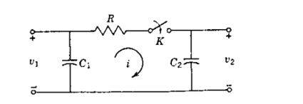

Is there a circuit diagram to go with this problem? There are several ways to connect three components, and various polarities for the charges on the capacitors.
RCC picture
upload picture

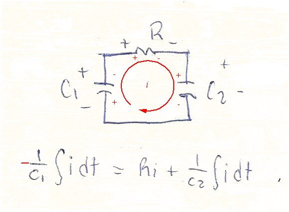

Later i discovered that I have a mistake with voltage law, then i resolve the DE and had Ce^(-t/r)
After that i make a sim, and see that the current in t=0 is -1A and tends to zero when t goes to infinity. So the function must be -e^(-t).
(r1=equals 1).
I saw voltages too, but i can't figure from which function they come.
The initial current is unlikely to be negative if initially v1 > v2. Also, how do you arrive at a time constant of 1s? By inspection we can see that the current loop has C1 and C2 in series with a resistance R. What's the effective capacitance for C1 and C2 in series? The time constant should then resolve to RCeff when you solve your differential equation.
Perhaps you should show more of your steps used to solve the DE.
Yes, you were right.

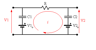

Don't let the initial potentials on the capacitors fool you into making wrong choices regarding potential drops due to current flow through them. Whichever plate of a capacitor the current flows INTO with be the + plate as far as the potential drop for the differential equation is concerned.
If you want to make it more obvious, note that you can model a pre-charged capacitor as an uncharged capacitor in series with a voltage supply:
