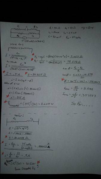

I've been working on it and here Is what I've got so far... not really sure any of it is correct though. (Sorry its so big, can't/ don't know how to resize it)
I don't really have an answer for much. I guess the power disapated in R1 and R2 but I'm pretty sure my current calculated running though R2 is wrong.
Any more guidance will be greatly appreciated!
Hello B. Vane,
You have the right idea up to a point.
In the first branch (the one that has the capacitor, inductor and resistor) things look pretty good up until the point where you calculate the current at time t = 0. It is not necessary to calculate the instantaneous current in the circuit. I think the problem as asking for the "average" power dissipated by each resistor, not the instantaneous.
Just use the rms current, when calculating the power.
In the second branch (the one that contains an inductor and resistor), again, use the rms current, rather than the peak current, when calculating average power.
As collinsmark said, when you use ##Power=I^2R## that formula needs the RMS voltage.
For (b) you have to repeat the calculations, this time retaining ##\omega## in the reactances because you'll end up solving for that value of ##\omega## that makes the resistors' powers equal.
