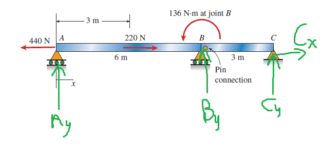

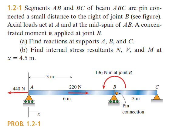

I am just concerned with part a.
I got the correct answers doing this:

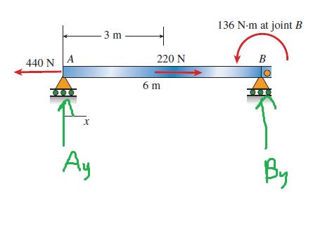

First, FBD of segment AB:
+cw ∑M_A=0: -136 - 6*By = 0
By = -22.7N
two ways to get Ay:
one:
+cw ∑M_B=0: -136 + 6*Ay = 0
Ay = 22.7N
two:
∑Fy=0: -22.7 + Ay = 0
Ay = 22.7N
FDB entire beam:
∑Fy=0: 22.7 - 22.7 + Cy = 0
Cy = 0
∑Fx=0: -440 + 220 + Cx = 0
Cx = 220N

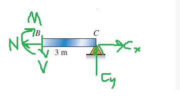

Ok, so I got the correct answers. However, here is where I get confused. If I make a FBD on segment BC I get a different answer for Cy.
My attempt at a FBD:
this leads to either:
∑Fy=0: -22.7 + Cy = 0
Cy = 22.7N
or
+cw ∑M_B=0: -136 + 3*Cy = 0
Cy = 45.3N
Clearly my FBD is wrong for segment BC. I assume the correct FBD would have a zero reaction at point B; this would give the correct answer (0) for Cy. In order for Cy to be zero, there must be no forces or moment at point B in the FBD, but this doesn't make sense to me.

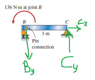

Your free body diagram is wrong because when looking at that segment between the support at B and C , you must include the internal moment in the beam at B. Far simpler to take your FBD between the pin (just to the right of B ) and C. In this manner, the applied couple does not enter into your diagram.
So my fbd is just missing an internal moment at B, and the resulting equation would be:
+cw ∑M_B=0: -136 + 3*Cy + M_B = 0
I can't solve directly for Cy since I don't have M_B.
Is this correct?

Would I not still have to include an internal moment? Wouldn't a complete diagram look something like this?
Is this correct?
yes
unlike at an externally pinned support , there can be no internal moment in the beam at a pinned connection.
