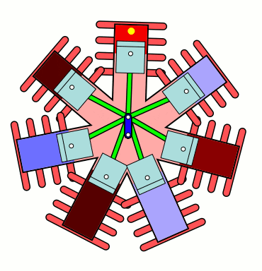

I Reaction moment on I.C. engine when we increase RPM

Every time when you increase RPM on longitudinal placed internal combustion engine, car shake to side in oposite direction of crankshaft rotation.
This is reaction moment for change in RPM of crankshaft/flywheel.
How this reaction moment transfer to engine block/car if crankshaft is separated from block with oil film?
(In the case or electric motor is clear, electromagnetic force between rotor and stator transfer this reaction moment to motor hausing)

Because gas pressure in the cylinders, push the piston and cylinder head apart, and the power stroke is always in the same direction.
The forces associated with the change in the angular momentum of the engine, are transferred through the engine mounts to the body.

The piston/cylinder pressure-induced force is converted to moment by the crank. And vice-versa
John Mcrain said:
Yes I know that reaction moment must exist(Newton law), but I want to know how this moment is transferd, at which points exactly..
As explained above, the only “solid” bridge of connection is the exploding gas (repidly increasing pressure) inside the cylinders.
Those are internal forces pushing the same amount in both directions.
You could only avoid that reaction by using an external force to speed the crankshaft up (hand crank, hill or people pushing the manual-transmission-car, etc.), or using a counter-rotation shaft that cancel the reaction.
John Mcrain said:
Reaction moment is transferd to engine over contact between piston thrust side and cylinder wall?
The sides of the cylinder wall are not important. The area of the cylinder head (while the valves are closed), is opposed by the area of the piston head. The piston pushes on the offset crank through the connecting rod.

I'd never thought about it much before, but yeah, this kinda has to be the case. During the power stroke, the rod is not parallel to the cylinder bore, it's angled, and therefore is transferring a significant side load that must be the primary torque acting on the block. You could mitigate this by moving the bore to be more centered over where the rod is during the power stroke rather than having the bore centered over the crank, but then the pressure forces acting upwards on the head would generate a net torque around the crank (since the upwards force vector on the head would not be aligned with the crank, it would be offset and therefore be acting over a moment arm). Modern engines do tend to have a bit of a bore offset, so it's a combination of both (though you'd have to run some calculations to know which factor is larger).

The side force on the piston is a distraction, not a significant contributor to the usable engine torque that appears on the crankshaft, relative to the engine block.
Imagine you lengthened the connecting rod, the engine torque would remain the same or increase slightly, while the piston side force would be reduced. At the same time, the crank offset is close to perpendicular to the connecting rod near maximum torque, so the reaction to piston side force does not act tangent to the crank rotation.
The engine torque appears from a triangle defined by three pins. The main crank shaft axis, the offset crank pin, and the wrist or gudgeon pin in the piston. The side thrust of the piston is not part of that major triangle, but is countered internally by a tension in the fixed crank offset.

And yet there has to be a torque applied to the engine block by the rotating assembly, and there's really only 2 places that can occur: offset pressure forces on the head relative to the crankshaft load due to offset bores (as you mention), and piston side loading. In a hypothetical engine with zero bore offset, 100% of the torque being applied to the block by the rotating assembly *must* be getting applied. There's no other mechanism, and of course there has to be a reaction torque by basic Newtonian mechanics.
I am not disputing the presence of piston side force. I am simply saying that it is an insignificant component of the power output from an engine.
cjl said:
And yet there has to be a torque applied to the engine block by the rotating assembly, ...
The useful torque output from the engine assumes the block is a fixed reference, the block does not rotate in the engine mounts. The engine block is firmly attached to the gearbox housing, which is also mounted to the structure. It is the sum of all crankshaft torque that passes via the flywheel, to the gearbox input shaft, that provides propulsion.
I assume a simple geometry, with the axis of the cylinders passing through the axis of the crankshaft main bearings.
There is no piston side force at TDC=0°, or BDC=180°, when the crank arm is in line, parallel with the cylinder axis. Nor at those instants, is there any crank torque generated by either side or axial piston forces.
When the crank arm is at 90° or 270°, and the engine is doing work, there is a side force on the piston, but there is no torque generated by that on the crank. Then, crank torque comes simply from the axial piston pressure, stepped sideways by the rod, and applied to the crank pin. There is only an internal equal and opposite force, trying to change the offset of the solid crank arm, which is a purely radial force, not circumferential to the crank shaft axis, so not generating torque.
The pistons do not rotate, it is the crankshaft that rotates. The piston does not move sideways significantly, so the side force is an internal balanced force. No useful work is being done by the side force of the piston on the wall of the cylinder.
