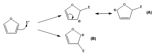

What is the major product of the following reaction?
(Its CHCl3)
Reimer Tieman reaction
This reaction looks like the Riemer-Tiemann reaction. The only difference is the reactant. First step is the formation of carbene.
Then either of the reactions are possible:
But since carbene does not react like an electrophile, It seeks the carbon with higher electron density. That is, it attacks position 3 or 4 to form product (B).

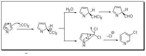

But in case of Pyrole, the major products are:
Why is there a difference in the type of products?

Why doesn't Furan react like pyrrole towards carbene?
Likes Sujith Sizon
Is there any problem with my question?
No, just that I don't know the answer.
