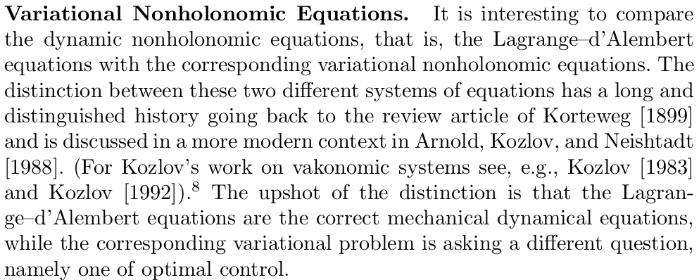

and as @mpresic3 points out that Goldstein’s treatment of non-holonomic constraints might be wrong. I am not sure, you would have to ask @wrobel or @vanhees71.
I believe the formula in the latest print of Goldstein has come to be known as “vakonomic”. It has been shown that this formula doesn’t satisfy the zero virtual work principle.Also I still don’t understand canonical transformations and action angle variables.

Goldstein doesn't treat non-holonomic constraints right when treating them within the action-functional formalism. AFAIK with D'Alembert's principle he does it right, and the correct treatment of non-holonomic constraints within the action-functional formalism (Hamilton's principle) must be equivalent to this. A much better book on classical mechanics is Landau & Lifshitz vol. 1, and there everything is correct.
Likes dextercioby, hutchphd, JD_PM and 2 others

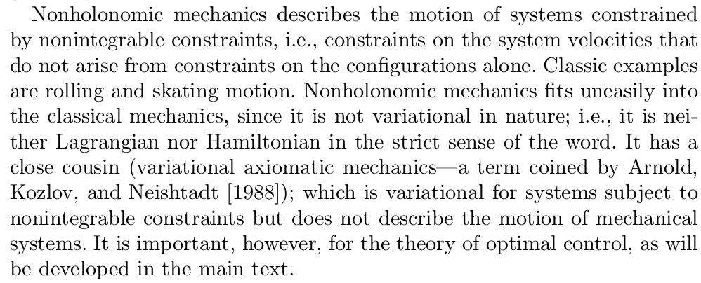

Let me just recall the following
[Nonholonomic Mechanics and Control (Interdisciplinary Applied Mathematics) (Anthony Bloch, et al]:
I must qualify this criticism. It's unjust to blame Goldstein for the blunder concerning nonholonomic constraints within the action principle. It's only the additional authors of the 3rd edition who introduced this nonsense. In the 2nd edition it's correctly treated as constraints on the variations ("virtual displacements") and thus in accordance with d'Alembert's principle and last but not least Newton's equations of motion as it should be.
