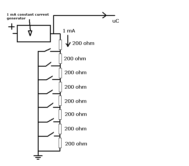

You could try something like this:
https://www.physicsforums.com/attachment.php?attachmentid=23063&d=1263484994
There are many constant current source circuits.
If you got one that would produce 1 mA, the top switch shown would produce 0.2 volts to the processor if closed.
The next would be 0.4 volts, then 0.6 volts 0.8 volts etc up to 1.4 volts. With no switches closed you wouuld get 1.6 volts. Nice regular steps.
If you used a current of 0.909 mA you could use 220 ohm resistors which would be easier to get, but they should still be 1 % tolerance if possible.
You can add extra switches and resistors if you like.

@vk6kro,
Thanks for the circuit. This one looks very similar to the one shown in the link that I posted, except for the use of the constant current source.
I think my main issue here is determining how to handle the multiple button press issue... What do you all think? Again, I don't care what button combination was pressed, but I just don't want it to cause the system to think something was pressed that wasn't correct.

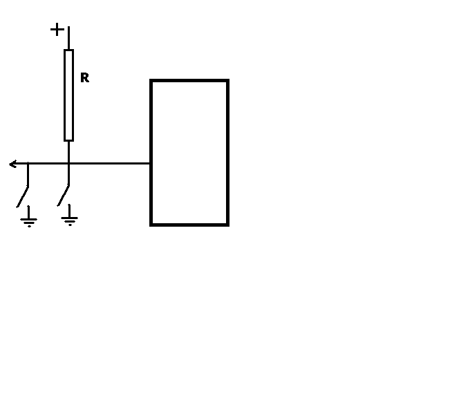

So, if you just have a pull-up resistor at the single analog IO pin of the microcontroller and all the buttons in parallel to ground, if any switch was pressed the input would be pulled low.
Is that what you mean?
Yep,
This method cannot get past the multiple switch problem. Then again, the scan line technique never could get past multiple switches and it became very popular. If you can't risk an accidental misreading, then the best way I can think of is to use a PCF8575 from NXP/Ti or use a cheap processor via UART. Then run your stolen pins from the port expander.
