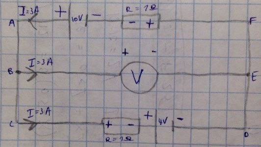

(a) In the circuit shown below E is a cell of source (internal) resistance r and the resistance of R is 4.0 Ω. With the switch S open, the high resistance voltmeter reads 10.0 V and with S closed the voltmeter reads 8.0 V. Show that r = 1.0 Ω.
(b) If R were replaced by a cell of e. m. f. 4.0 V and source resistance 1.0 Ω with its negative terminal connected to B, what would be the reading of the voltmeter with S closed?
Answer: (b) 7.0 V.
2. The attempt at a solution
(a) E = I (r + R) → 10 = I (1 + 4) → I = 2 A. Then we find E = I r + V → E - V = I r → 10 - 8 = 2 r → r = 1 Ω. Looks correct.
(b) Maybe something like 10 - 4 = 1 I3 + 1 I1, 10 - V = 1 I1?

Then your calculation is not correct. The voltmeter is connected across EMFs and resistors. You've only assumed resistors and that they are connected in series between A and B. They are not.
Instead, do a KVL walk from A to B. You can choose either direction (via the upper path through the 10 V EMF, or the lower path via the 4 V EMF).
Likes moenste
10 V - 3 A * 1 Ω = V
V = 7 V
I used 10 V as you said, not 8 V.

Make a drawing of the circuit. Draw in the current direction. For every resistor that the current passes through place a small + sign where it enters and a - sign where it exits the resistor. That's it. When you do your walk along a path of the circuit just account for the change in potentials using those signs. + to - is a drop so it's negative. - to + is a rise so that's positive.
Some people sum the drops and treat them as positive, while rises are accounted as negative. There's aesthetic reasons for this having to do with making the math look nice for techniques they use that you haven't learned yet. So for now just make drops negative, rises positive.
Likes moenste
Question 1: how do we determine the current direction? At AF I looked at the 10 V and took the direction from the + side.
Question 2: voltmeter is like a resistor? Where current enters is a plus and where it goes out it's a minus?
ABEF: - V - (1 * 3) + 10 = 0. V = 7 V
BEDL: - V - 4 - (1 * 3) = 0. V = - 7 V. On LD both are minus since we are moving clockwise while the current is anti-clockwise as on the graph, therefore the signs are in the other direction.
If you can determine the current direction just by noting or even estimating the net EMF driving it, that's fine. But sometimes a circuit is complex and you can't determine ahead of time which way the current is going to flow in any given loop or along a given path if there are separate currents. That's fine! Just pick a direction and pencil it in. From then on just be consistent and use the same assumed direction when writing your equations. The math will sort it out for you! When you solve the equation for the current and the result turns out to be negative, then it just means that your initial guess was not right: the current actually flows in the opposite direction from your guess. The magnitude of the current you find will still be correct, and you can still plug the negative value into any equations you wrote and get correct results.
Yes. Although good voltmeters generally have very high resistance and pass negligible current. Unless you are specifically analyzing a voltmeter or how it affects a particular circuit, their current is taken to be zero. Ideal voltmeters shown on a circuit to show you where to "read" a potential difference are taken to have infinite resistance and so pass no current at all (effectively they are an open circuit).
http://tinypic.com/r/vnfmkg/9
In your diagram the 3 A you've shown for the voltmeter branch is not correct. It should be zero amps. If you do KCL (Kirchhoff's Current Law) at node B then you you would see that its sum would not be zero if you had two paths of 3 A leaving and only one entering.
You're going clockwise around the loop, so when you pass through the 4.0 V source you're going from - to + through it. That makes it a potential rise. You're also moving against the current when you go through the resistor, so again going from - to + and that's another rise. Both those terms should be positive.
Likes moenste
Ah yes, since it's a voltmeter there's no current. And since we got V = -7 V then the current is going in the opposite direction to the one we put on the graph. But we can still say that the voltmeter says V = 7 V.
This part was particularly helpful, I didn't get it before what is a drop and what is a raise.
I think this should be it concerning this question : ). Thank you!
Yes, but we are moving against the current. Therefore the signs should be opposite. - V - 4 (raise but opposite to the current so negative) - (3 * 1 raise but opposite to the current so negative) = 0.
Actually, the current shown on the diagram happens to be correct. It's your equation that didn't obey the rules (was wrong) :smile:
Voltage sources are completely immune to current. They keep their potential difference as-is no matter what current, or which direction the current is flowing. So always write down their rise or fall in potential according to the +/- on the symbol as you traverse them. In this case you go from the negative to the positive pole of the battery. That's a potential rise. It would only be a drop if you walked through it in the other direction.
You are passing through the resistor also from the - to the + so again that's a rise and positive.
