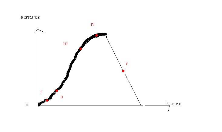

In summary, the physics professor walks home from campus via the sidewalk, and it starts to rain. Her distance from her house as a function of time is shown in the figure below. At which of the labeled points is her velocity zero?

A physics proffessor leaves her house and walks along the sidewalk toward campus. After 5 minutes, it starts to rain, and she returns home. Her distance from her house as a function of time is shown in the figure below.(ignore the paintbrush just assume that its a curved line)
At which of the labeled points is her velocity...
a.) zero?
b.) constant and positive?
c.) constant and negative?
d.) increasing in magnitude?
e.) decreasing in magnitude?
none
a.) zero?
none... i think zero is from the end after IV
none?
point V
from points I - II
from points III - IV

0 velocity exists at 0 distance (say displacement/deltaT)...velocity is zero seemingly only at limt = 0 and when her journey ends. 0 velocity also exists when limit of the point is a tangent line parallel to the x-axis...so...
a)Not an Optional Point
b)No Point
c)Point V
d)Point I and Point II
e)Point III and Point IV
-----------------Same Answers as Yours----------------------

Unfortunately, I'm not sure Gear300's answers are very helpful- he seems to be thinking of average velocity.
Yes, you are correct that as long as the graph is going upward, velocity is positive, as long as it is going downward it is negative. At the point where she "turns back", changing from going away from her home (positive velocity) to going toward her home (negative velocity) here velocity is 0. Unfortunately, on your graph, that is not one of the labled points!
I'm not happy with the wording of B or C: it makes no sense to say that the velocity is "constant" at a single point- "constant" velocity can only apply over a time interval. On a distance-time graph, a velocity will be constant where the graph is a straight line. Yes, the velocity is constant (and negative) on the interval containing V. The velocity is increasing where the graph is "convex up" and decreasing where it is "convex down"- it looks likethose occur at I and III respectively.
