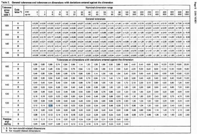

Hi all,
i have stumbled across a drawing which referenced DIN 16901 for its tolerance. I have a table of DIN 16091 which i don't understand.
For the first half of the tables, the tolerances are + and -, which i understand. The second half (tolerances on dimensions with Deviations entered against the dimensions) are without +/- symbols. Can i assume that the tolerances are always + ?
Thanks guys for your help!
It looks like the second set of numbers are just twice the top set for the given row/col
so if the cell says +-0.20 then the corresponding cell says 0.40
it Looks like it as well, but what are "tolerances on dimensions with deviations entered against the dimensions"?
I am inspecting a sampe, and have a drawing and the dimensions are with no tolerances. The only indication is in the remark section, "tolerances are according to DIN 16901".
