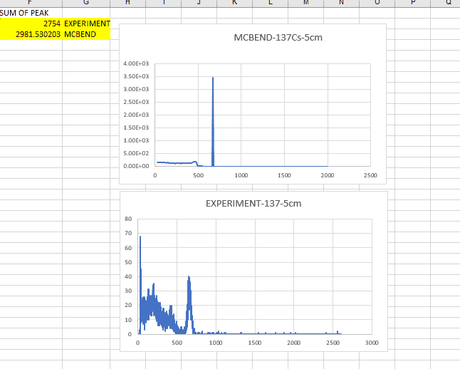

Do I need to apply normalization these two graphs to make them similar to each other and if so, how can I do this? I would be very grateful if you can help me if these results are consistent. I compared the results of the experiment and the results of the mcbend simulation.

What do you want to learn from your data? Where does it come from?
It's possible the simulation hasn't been scaled to match the expected experimental result. In that case a normalization is useful. If you want to normalize to the same integral, or same integral of a peak, or something else, will depend on your experiment and your data analysis goal.
yes, I did not scale the data. what I want to do is to make the graphs similar. But I don't know exactly how to make normalization

Similar in what way, for what purpose?
Your experimental graph doesn't have the same shape as the theoretical one so they won't match up nicely no matter what you do.
I think my code is the same as the environment I have set up. I am investigating the accuracy of the simulation. These are the measurements of my detector and I added my code
